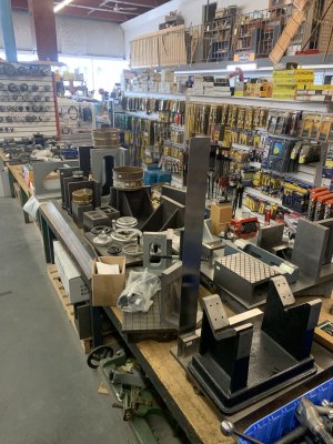

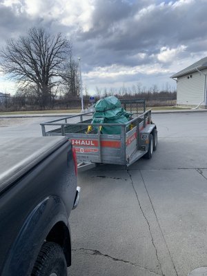

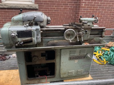

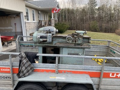

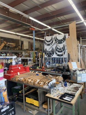

Just got home about an hour ago after a long day driving to kemptville from Hamilton to pick up this lathe.
It came with many many extras including several 3 jaw chucks, spare spindle, spindle bearings and an assortment of gears, sheaves and other odds and ends. I have the cover that is missing from the machine in the photo as well.

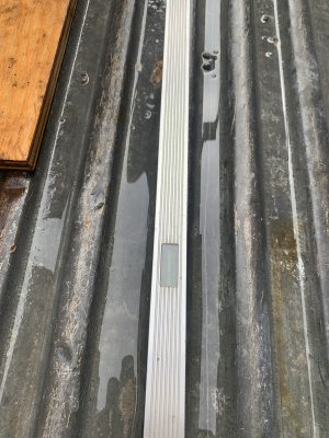

Stopped at Cardon Tools in Perth on the way home and ended up with a rough machined 4ft Busch dovetail straight edge along with some other small stuff.

That lathe looks like a beauty. Can't wait for the full inspection report, more pictures, and first chips! Nice! I bet you are a very happy camper right now!
I showed my bride those photos and she asked why my shop couldn't be as neat and tidy as yours! She thought that was your shop!
I'll be putting that place on my bucket list of places to go visit when I get old...... ;)

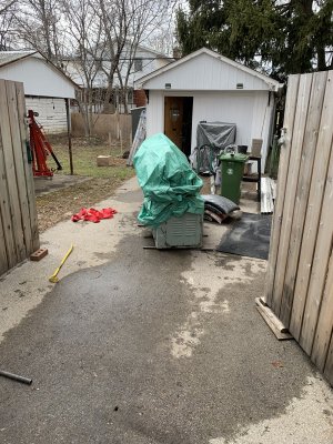

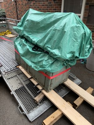

Rauce

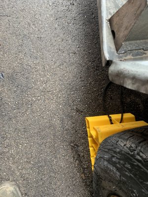

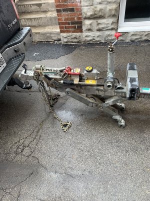

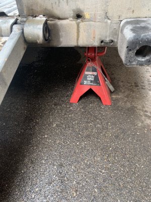

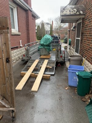

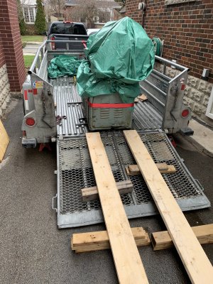

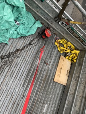

Just getting set up for removal from the trailer. The non-removable ramp on the trailer makes it impossible to use the engine hoist I borrowed from work.
I removed the straps and the haggard tarp from yesterday and liberally sprayed down all the exposed surfaces with WD-40. Retarped for now since it’s raining a bit.
Got the ramp assembled. This is the same method we used to load the machine.
I used the tongue jack to get the trailer to slope slightly and put some weight on two jack stands at the back end to keep the trailer stable as the machine slides towards the back. Chocked wheels for good measure.
I’ll put it on pipes and use a 1ton hoist and a recovery strap to control its roll to the back and down the ramp.
Now to wait for the rain to go away!

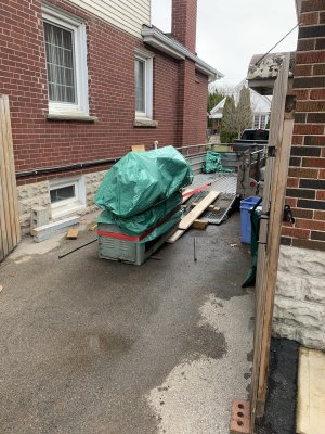

Rauce
As I set up I thought I may need another person but it became clear I could do it on my own but just go slower.
I had a couple friends available later this afternoon but wanted to get the trailer back to uhaul to avoid a late fee.
Took a little over an hour to get it down the ramp going a few inches at a time and going around to adjust pipes etc. No muscle needed.
Maybe later today or tomorrow once things dry out I’ll get the tarp off and do some inspection before getting into partial disassembly.
It looks like part of a scraping straight edge in the 3rd picture (left side middle) if anyone is looking for one.
Rauce
Doh! So what else are’nt you telling us? There is definitely tools to drool over there.
I was originally going to buy one of the angle blocks also in that same photo but went with the straight edge instead. Other than that I got a small tap wrench, a couple slitting saws and a couple countersinks. That was rest of the cash I brought with me so I left it at that.

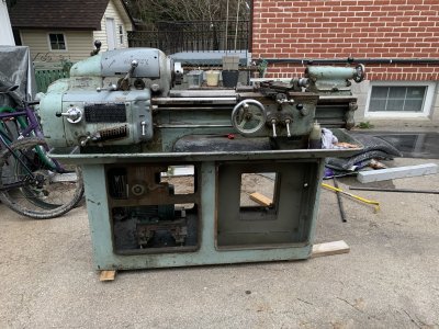

Rauce

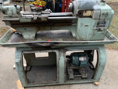

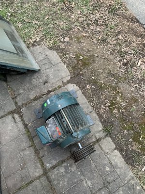

Last night before it got too dark to see what I was doing I took all the covers off the base and removed the motor, motor mount and levelling screws.
This morning I consolidated the spare parts into two bins and set up a little temporary work bench where my old lathe used to be.
The lathe came with three chucks, each with shortcomings. The largest is an 8” SCA steel 3 jaw that is missing the hard top jaws but came with aluminum soft jaws. I started in on it and it is grimy but in good condition with minimal rust. I’ll have look into hard top jaws for it, hopefully not too expensive. 8” is a bit big for this lathe but it would still be a useful chuck to have.
The other two are both cushman 3 jaw chucks. One is a very clean 5” chuck that only has the reverse type one piece jaws. Not sure if the regular one piece jaws can be easily sourced.
The least desirable chuck of the three is a pretty grimy 6” cushman that is a direct mount for a 2-1/4” (I think) threaded spindle and has been fitted to a home brew adapter of some sort. I’ll probably seperate the adapter and sell this one later.
I also realized last night that this lathe has an MT2 tailstock. Many of my centres, drill chucks etc. are that size from use on my old bench top Logan but quite a few things I bought for my last lathe will no longer be useful. I’ve offered them for sale to the guy that bought my Churchill lathe but if he doesn’t take anything I will post them in the classifieds here.

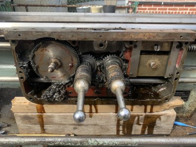

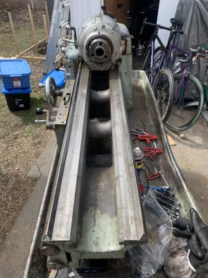

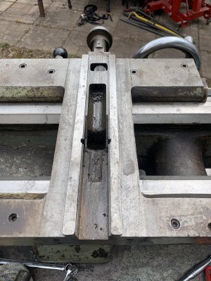

Into the thick of it now!
With the carriage off I have a much better view of the ways.
The carriage rides on the V on both sides. There is enough wear that you can see and feel it since the wear leaves a small ledge towards the bottom of the V.
The flat ways and inside angle that the tailstock rides on don’t show any visible wear other than some nicks and staining.
I’m going to try to quantify the wear soon using a precision V block and indicating to it from the flat way. If I had to put a guess on it I’d say maybe .004” in the most worn area.
