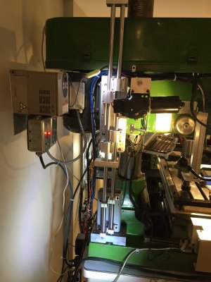

Filled the column with what?
Post some pictures of the extra hardware to maintain registration please.
Filled with some sort of cement specified for this purpose (filling of hollow structural beams and machine bases) + a few pounds of lead for good measure.
I added linear bearings and hardened shafts to maintain registration when lifting the head. The linear bearings were an Amazon thing that came as a pair so I decided to use both.
I did one other thing that also helped, I added thrust bearings to the three column clamping bolts, and then made permanent long handles instead of messing with a wrench. This was really worthwhile because I tighten more with a fraction of the effort.
I also added a surplus Princess auto windshield wiper motor to replace the crank when lifting the head.
All in all it makes lifting/dropping the head a near painless experience compared to the original method.

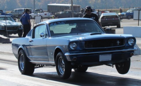

@slow-poke , what I would like to know is... what rear gear you have stuffed in the back of your mustang profile pic haha.
Good question
That's a really old picture, and there is a story......
When I first started racing I had a buddy from work that was a bit more hardcore than me (dragster etc). My little 289 could get a little air under the tires and I wanted more but did not have the funds for a lot more power. My buddies solution "just for fun lets throw in this 9" pumpkin from my tractor pull setup, you will get some air" that's were the sig picture came from. I barely had time to think before I had to pull the V-Gate for the 1-2 shift.
It's not the fastest way though, too much energy going up and down instead of forward, you just want a little bit to help traction.
The flight is all part of the fun when dialing things in.
