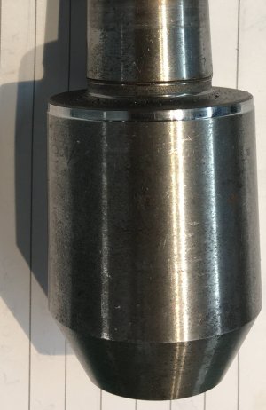

You could always turn the stub down on the Arbor to a more popular matric size, 22mm is a pretty popular size, 5 minutes on the lathe

You could always turn the stub down on the Arbor to a more popular metric size, 22mm is a pretty popular size, 5 minutes on the lathe
Same thought crossed my mind. How hard would that stub be?
I use carbide cutters on my lathe.
This might be a good solution to open the door for all the 22mm face cutters that seem to be everywhere.

Chances are your arbor might not be an exact fit for these unless you buy one from the same seller, mine wasn't.
I'm struggling a bit to understand your advice here.
@slow-poke is looking for a face mill with an MT3 Arbour with a 3/8 drawbar. This doesn't seem to exist that he can find. I have an old arbour I could give him.
When you say an exact fit are you taking about the mods you describe or are you talking about other aspects not discussed?
The screw and drive dogs shouldn't be an issue at all.
The stub length isn't either. But I'd shorten the arbour rather then deepen the cutter simply because there will probably be more cutters in the future.
I don't know if @slow-poke has the ability to do these mods.

Regarding turning down the stub to 22mm, well curiosity got the better of me this morning so I put an old arbor that I don't use in the lathe just to see how it would respond to the cheap carbide cutters I'm using in my lathe. I realize this is somewhat of a meaningless endeavor because this arbor might be much softer than the Susquatch arbor.
I did make a few scratches with a fine tooth file to get a sense of how soft or hard this arbor is and I would say not soft but not heat treated hard either. My lathe has no problem with light passes.

Hi @Susquatch What I'm trying to say is that details like the length of the stub and dimensions of the drive engagement interface might be different between arbors sourced elsewhere and the BAP heads. In my case it was the engagement length of the stub in the head. When I ordered the BAP head I gambled on getting a fit. In a quick scan of cutting heads and arbors I see plenty of references to 1" fit but no dimensions for stub engagement. Maybe there are standards but I haven't seen a reference yet.
I weighed cutting down the arbor but decided that every head supplier could have a slightly different interface so since I have a good quality, non-far east arbor I'd rather mod the low cost head to suit instead possibly burning bridges (for other, non-far east head sources) by modding the arbor. The BAP head is easily replaceable if it doesn't work out.
I make no comment about the availability of MT3 & 3/8 drawbar, mine is R8.
WRT existing heads do you mean that yours have brazed carbide lathe tools for "inserts"? They look pieced together but clever compared to today's insert tools.
