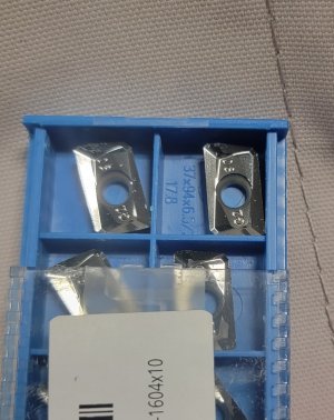

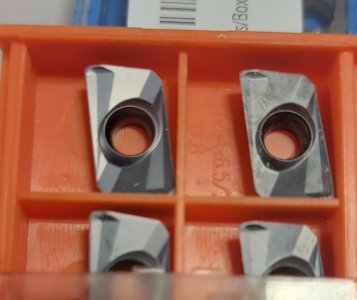

Here are photos of the rectangular APKT Inserts in steel, stainless, and aluminium. I have used all three and I can say that they work great on my 2HP Hartford Bridgeport Clone with an R8 Arbour.
Yes, there is a tap tap tap sound as the cutter starts to engage the side of the work. It doesn't bother me nor does it affect the quality of the cut. I agree with others that the 45s and especially the rounds would be gentler on entry. Personally, I don't think it really matters much one way or the other for that. However, I'd guess that round would probably leave a better trail between passes if that matters. I like not having to change tools for transitions and the vast majority of my transitions are 90s. The other thing is that I like to standardize inserts. My impression, right or wrong, is that the 90s are more common.
Pick your poison!

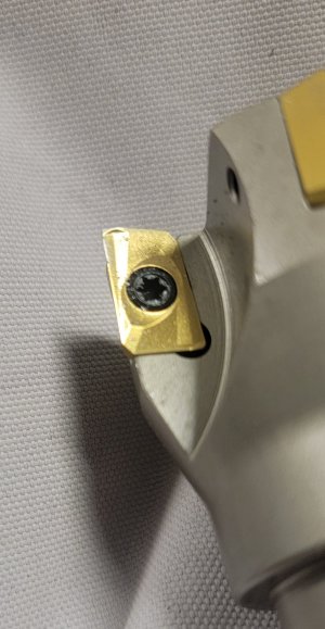

@YYCHM hey Craig, I also have this type of face mill never used it. Could you expand on the issues you found with triangular insert cutters?
The inserts aren't very sharp and they aren't secured to the head very well. I'm not convinced all the insert cutting tips are in the same plane (i.e. on cuts more than the other two). It does work, but doesn't leave a great finish IMHO.
Try loosening the insert hold down screws.... The ones on mine are brutally tight.
My insert screws are a firm fit and not overly tight. Actually I've not had reason to use the face mill and with the motor only being 3/4 hp I'm somewhat hesitant cluck, cluck, cluck.

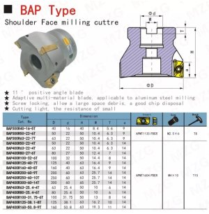

@Dusty & @slow-poke - I found this on Ali.
Note the 25.4 dimension down about 3/4 of the way down the list. That 25.4 is exactly 1".
The first one is roughy 2.5 inches and the second is roughly 3 inches
The drive dogs are wrong, but they can be made to fit. Same goes for the stub retainer.
I'm gunna keep looking but one of these might be worth a try.
