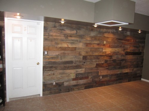

I have been looking at other options of wall coverings. When I poured the pad, I got the 6 inch curb wall. The idea was to keep the drywall off the floor and gain a little more height. That adds a fair amount to the concrete pad.
An interesting wall covering I found online is pallet walls. Reclaimed wood from pallets. Sure looks good on some of the online photos, but I can only imagine the mess mine would look like. lol
My garage was already built or I would have had 6-8" curb walls poured. oh well!
I don't know if code right now requires drywall, but a quick call to City of Calgary Development analyst will get you to the answer.
Great idea for a wall, and somewhat free, too -- a lot of work, though...

@Chicken lights Pallets don't make good firewood do they? 😛 Good point on the fire hazard. I'm leaning back to drywall.
