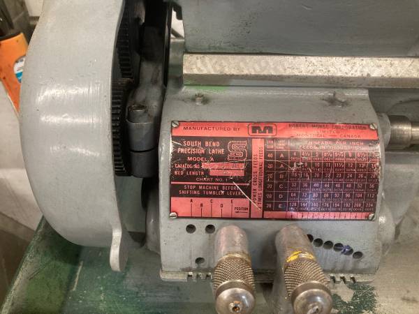

Did find this 1966 under drive South Bend 9 for $3500.
Contacted the owner, waiting to hear back.

What size SB did you have before. I don't remember although I'm sure I saw it.
