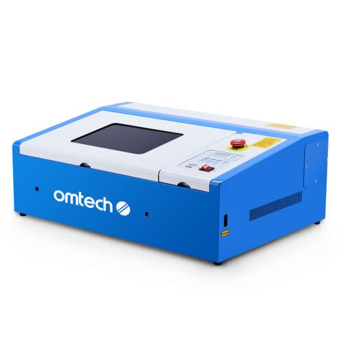

My K40 CO2 laser showed up this week.
Today the control board arrived and I ordered all the parts to expand the cutting area from 8" x12" to 12" x 24" (or thereabouts)

For those of you following along at home, this is the approach I'm taking with the K40 conversion:
Hardware needs are 2020 and 2040 extrusion, v-wheels, eccentric adjusters, pulleys, belts, a pair of NEMA 17 motors, 5mm cap screws and a whack of 3D printed parts.

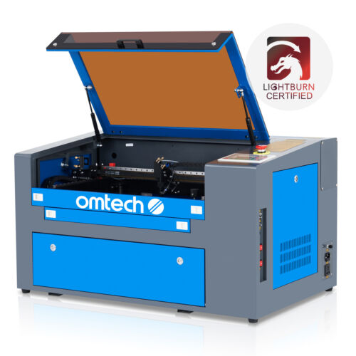

My rationale for this conversion is that I can get a 12"x24" cutting area at a fraction of the cost of a built unit with the same cutting area.
A generic import 50W laser is $1600 CDN and they don't have controllers compatible with Lightburn which is the bee's knees for laser cutting and engraving. Add a compatible controller and it's now a $2000 CDN machine.
OMTech makes a well regarded 50W but it's $2600 CDN and has a 12"x20" cutting area.

@Dan Dubeau the cheapest 50w CO2 laser I found was around $1600 CDN. And it had a bed area of 12”x20”. I don’t think the control board was Lighburn compatible.
So an upgraded K40 seems to make a good deal of sense to me.
