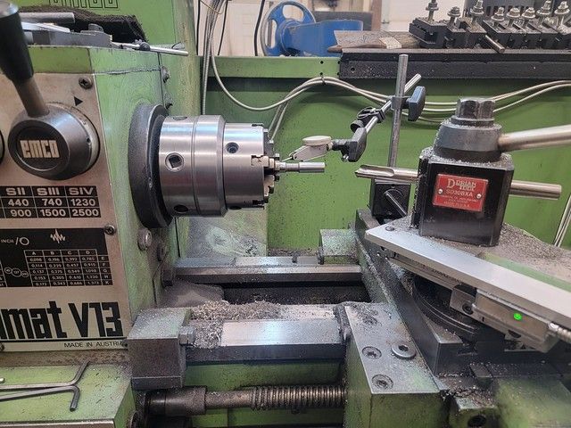

Been busy in the shop lately, but finally got some machine shop time.
When i sold my Emco V10P, I kept a couple of the chucks I had for it. One Bison 5" set tru 3 jaw, and a 4" 6 jaw set tru Buck. The V10P was a threaded spindle, and the V13 is D1-4, so I had to adapt them to new backplates. I couldn't find reasonably priced direct fit. The Bison plate was about $650. I bought two 6" backplates from ebay for $60 each but they needed a lot of work. Here's some pics
This was meant for a set true chuck, but the ID was bigger than the OD that i needed for the 4"
Made a new spigot for the set true set screws to push against.
I cut the new 'spigot' to have about a 1.5 thou press fit.
I slathered a bit of retaining compound on it and tapped it into place
Then i parted off the excess spigot, faced it to length, cut it to diameter, and finished the face of the backplate
Here it is with the chuck bolted down and adjusting for runout
Looks pretty tiny...4" chuck on a 13" lathe, but its a 6 jaw, and runout is very good across the range of jaw capacity, maybe 2 tenths.
