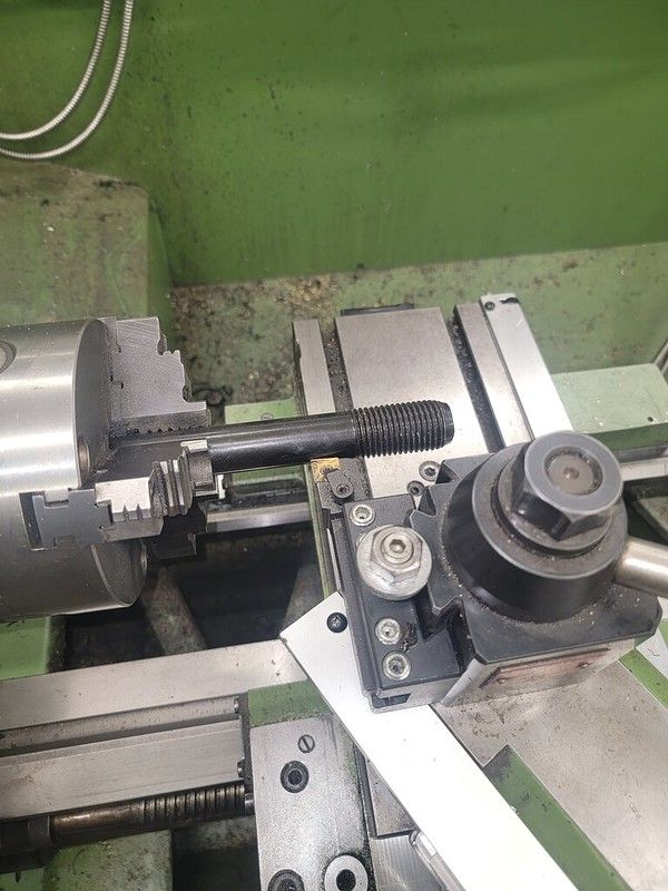

A pic with a toolholder to show that the scale and guard isn't really that close to the action.

My real concern was a scale on the cross-slide. The chuck side is too busy, and the backside can get hit by the tailstock. Some users even deliberately make contact with the tailstock routinely.
There is a stop on the bottom of the tailstock to prevent it from hitting the carriage. It's about 1/8" short for preventing the tailstock from making contact with the reader head. I need to make an extension for it.
