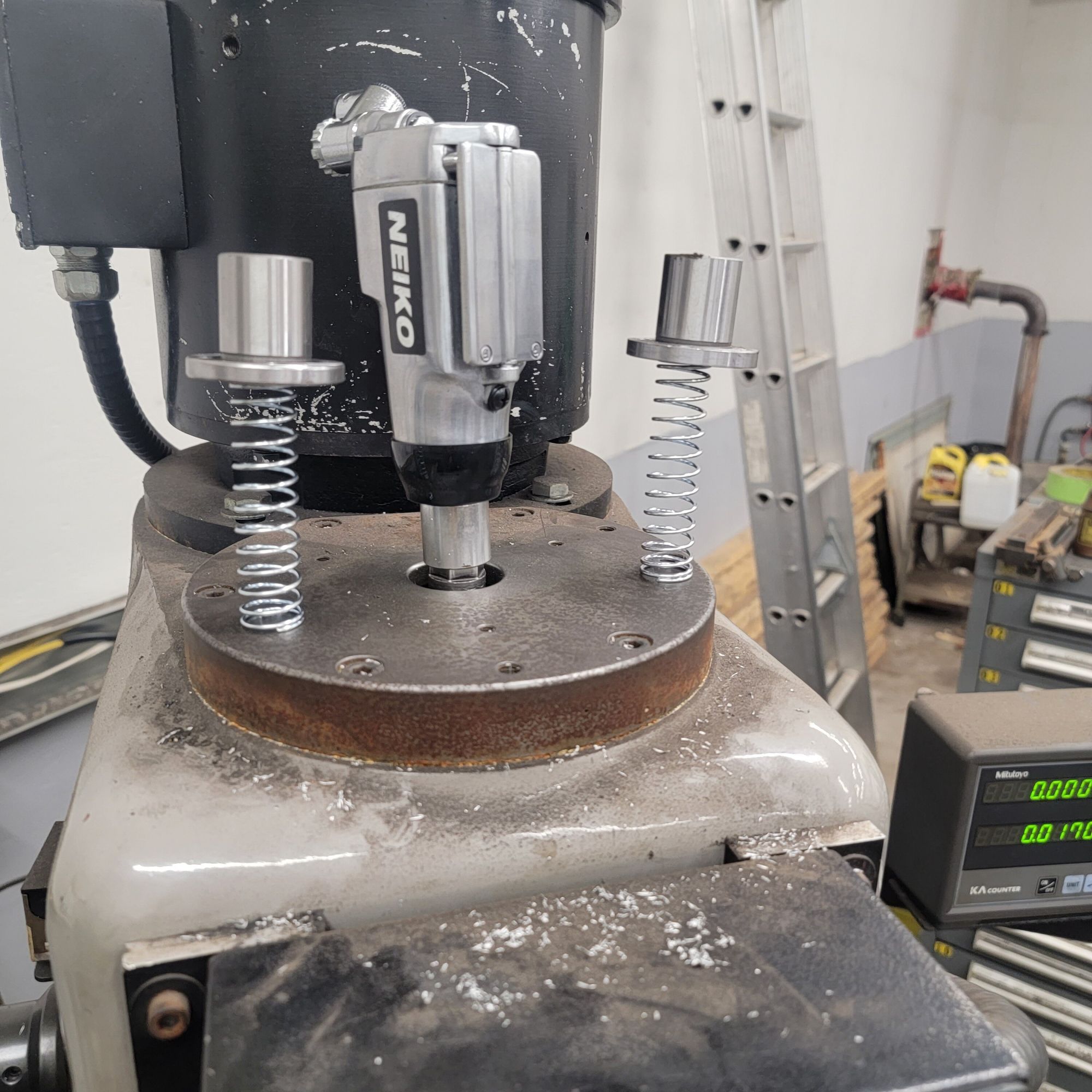

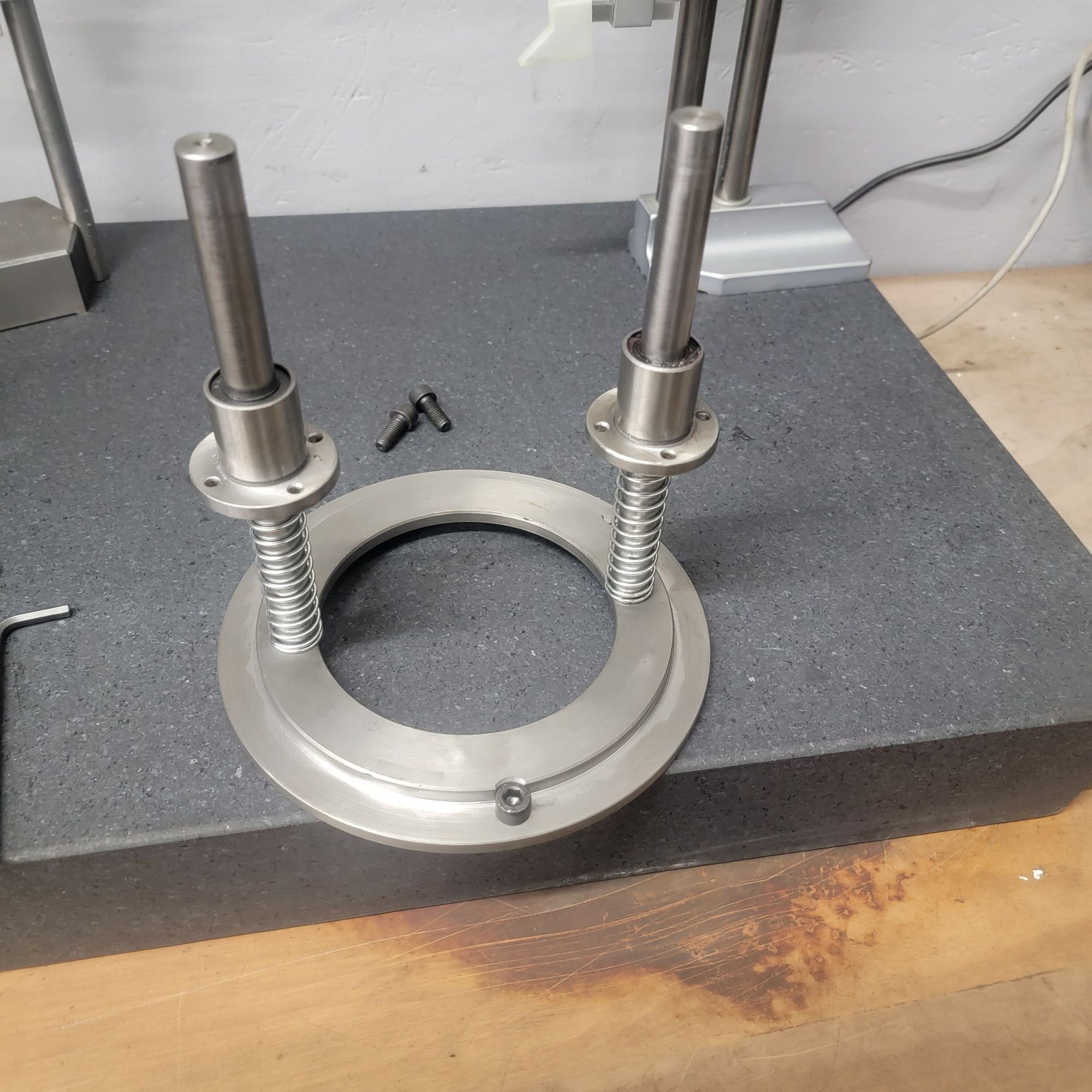

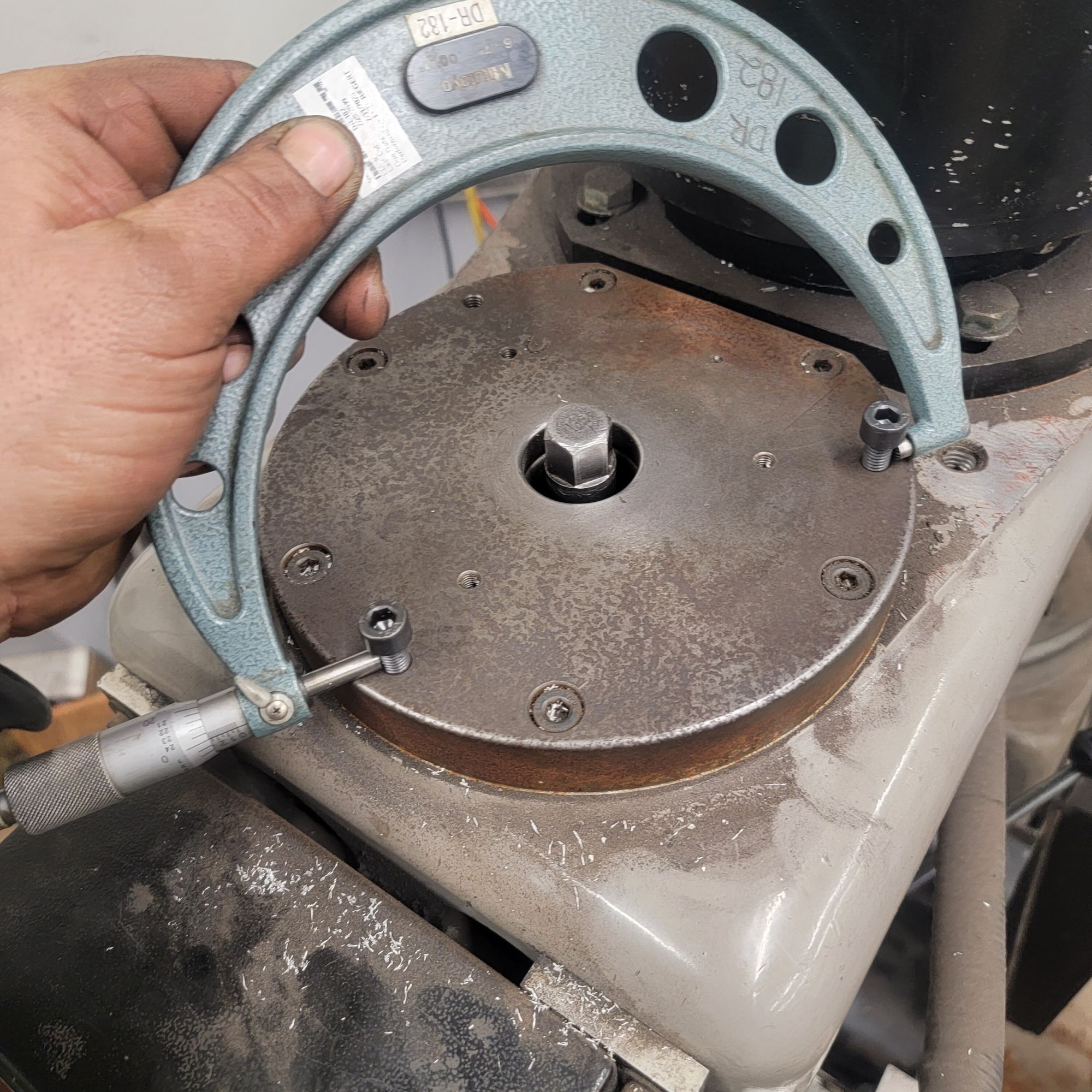

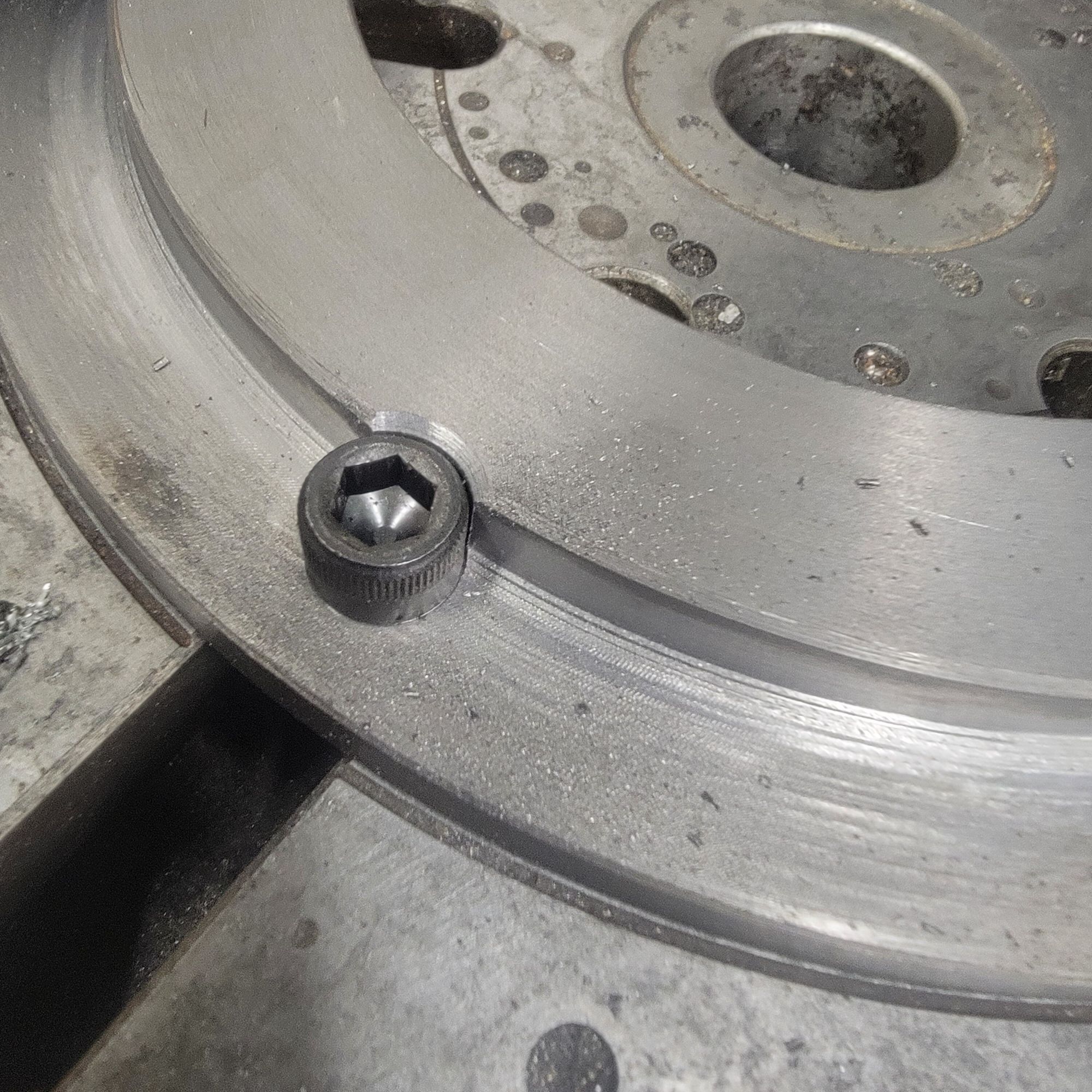

Finished up the power drawbar today. I'm going to do a bit more with the airline but not until my shop piping is done. I can't believe I didn't do this sooner. It works awesome!
