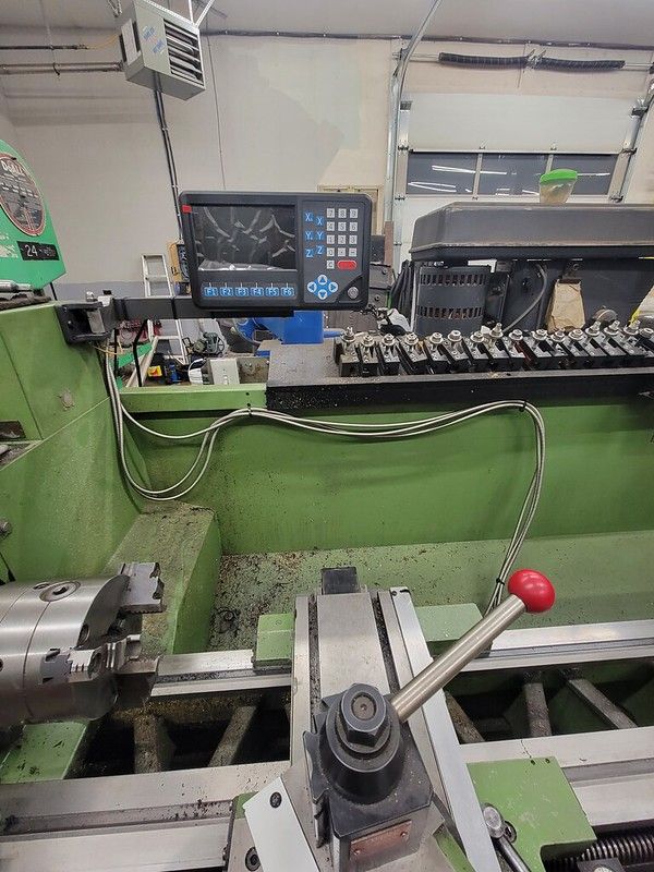

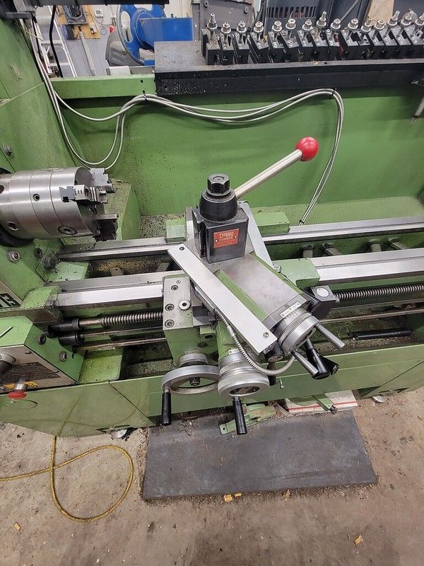

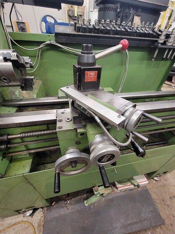

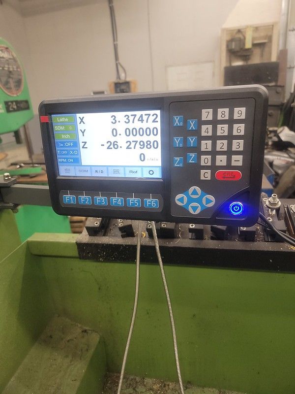

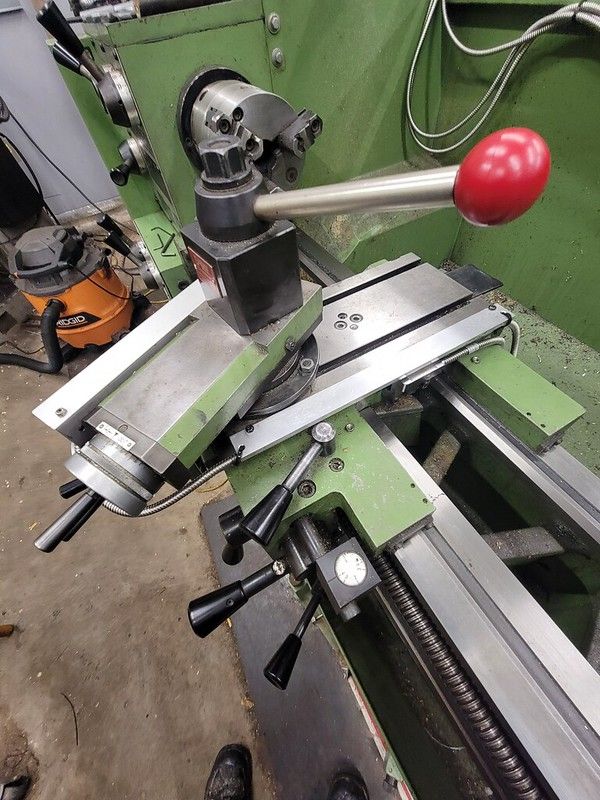

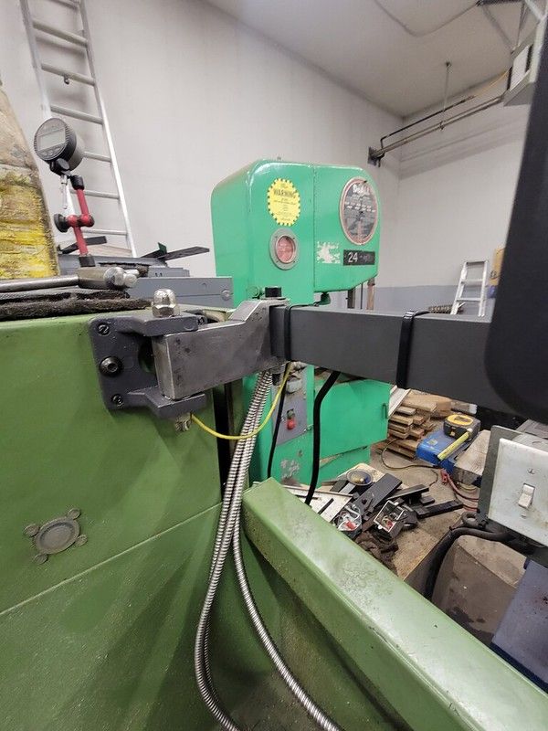

Found a bit of time to finish up the DRO install on the Emco V13 lathe. I'm not entirely happy with the guards the way i set them up, and will be changing a few things, but for now they will work. I really like having the RPM readout on the display all neat and tidy. With the VFD, its variable from 6 rpm in low gear to over 3500 in High gear, so its nice to know. I still have to do some compensation on the X axis, as its off about 0.001 over 2", and these are all 1 micron scales, so it should be able to be bang on.
Here's some pics:
Does your lathe have a FWD/OFF/REV handle off the apron that activates motor contact switches in the headstock area? if so, what was involved with plumbing electrons to integrate the VFD?
yes it does. The switch is in the cover plate for the QCGB, it has a common, and fwd/rev contacts that would normally go to the fwd/rev contactors in the cabinet at the back. They now hook up to the VFD and tell it what to do.
