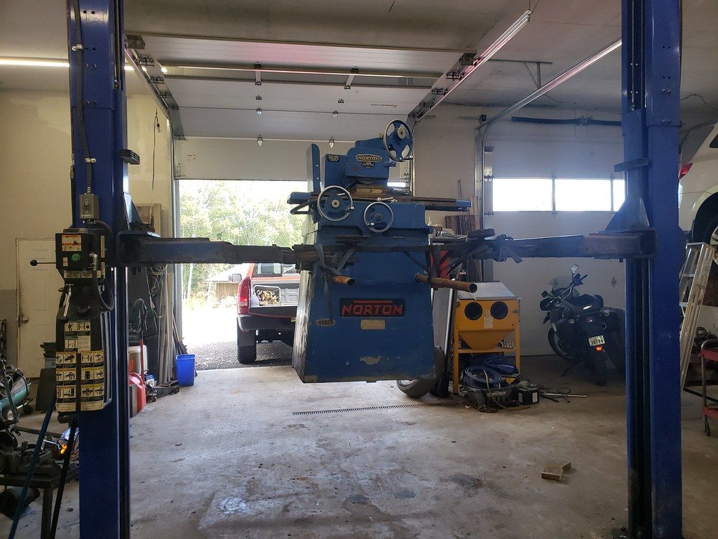

For anyone wondering how the lift went, it was a piece of cake!

I wasn't just wondering, I was waiting with baited breath!
I'm thrilled to hear it all went as planned.
Well done!
It started lifting off the trailer as i tightened the one ratchet strap. It was perfectly balanced. I'm guessing its less than 3k lbs. Hoist didn't know it was there.
I can see the smile on your face from here!
