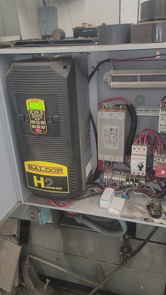

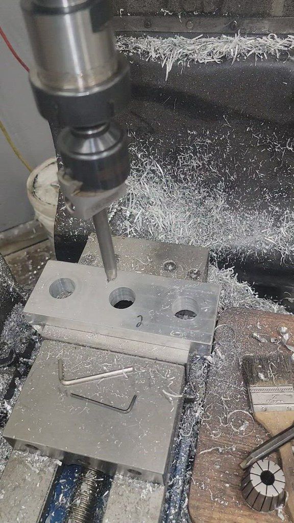

i have a few more i just took, to illustrate some points of a ok-ish vfd install.
20220131_213843 by Darren Floen, on Flickr

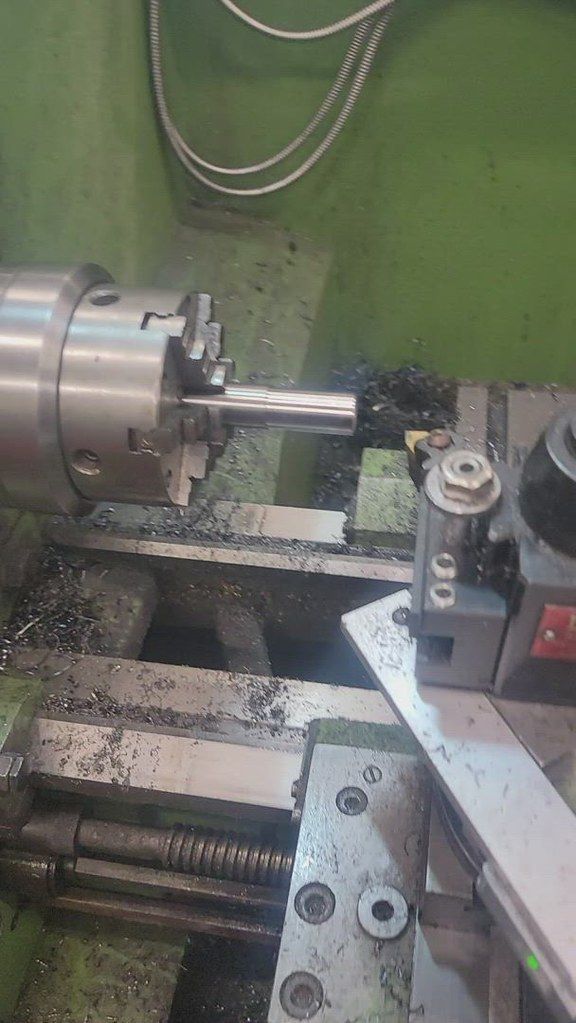

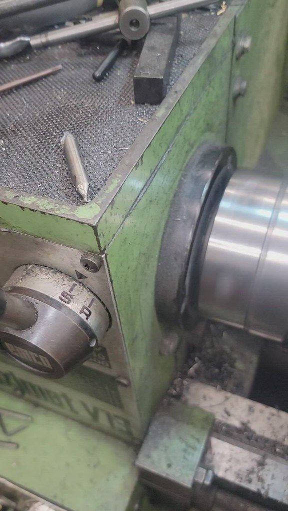

This is THE WORST material i could have picked for a demo. Its chromolly and its a bastard, but it illustrates that a fine adjustment can make a big difference in finish, chip control, etc
20220131_214042 by Darren Floen, on Flickr
20220131_214220 by Darren Floen, on Flickr
20220131_214258 by Darren Floen, on Flickr
20220131_214623 by Darren Floen, on Flickr
anyways, hope the videos work, i'm just messing around in the shop tonight, and thought i'd show why i like VFD's so much. I'll fire up the big lathe if someone wants, and show the other reason i like vfd's

Gesus @dfloen. Sometimes I can be a total idiot.
I already noticed I can fine tune finish by using the "on the fly" speed control of a VFD on my pulley drive mill. NICE!
But for cerebral deficiency reasons that only my wife understands (and reminds me regularly), I never really thought of the advantages of doing that on my lathe too. I even noticed you doing it in your first video and I actually commented on how cool it was. BUT...... that particular neural connection was totally blocked by my personal goal of achieving lower speed.
Your second set of videos overcame my blindness and drove the point home in a much better way. Suddenly I realize (and have fully assimilated) the idea that speed adjustment ON THE FLY (higher and lower) is a worthy goal all on its own on the lathe too!
THANK YOU SIR Darren!!!
I think I'll move that lathe vfd project a bit further up my priority list.....
Very nice Darren. A GREAT set of videos for illustrative purposes. I don't see how anyone could watch those and not be convinced of the merits of a VFD.
A few questions:
Is that brake that keeps "popping" in and out automatic? If you use the direction controls of the VFD, does it still engage? Or does it just smoothly slow down and change direction?
I noticed that you can really feel (hear) the inertia in that big lathe on your last video. Especially coasting along without any load. Did that happen before you installed the VFD too?

I have a similar busybee mill that I converted to vfd and really like it. I used cheap Amazon vfds and so far all is good.
Thats the brake. I need to fine tune it a bit more. Right now it comes on at 18hz, so the vfd is set for 20-120hz, so when stopping the vfd brakes to 18 then the brake comes on. I'm going to play with it more when i have time. Its all easily tuneable, but this works pretty decent.
The big lathe has a big brake resistor and a electro brake as well, it just has 20 times the inertia to stop. That and the vfd will trip on decel sometimes, so i had to extend the braking time.
