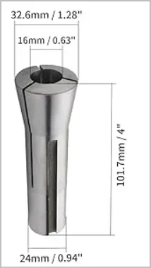

A slotted set screw that wasn't actually tight against the second. The second has a turned down piece that is no longer round. Instead it has two flattened edges. Not sure how that happened. Diameter was about 0.1325 with a length of about 0.1325.
When you look at an R8 holder you'll see that only the top 1.125" or so is precisely ground. Further along it's got a slightly smaller diameter. Inside my spindle the set screw pokes out at more like 1.75" or so. I didn't measure that precisely. It comes out in a roughly finished bore.
In other words the set screw engages below the precisely machined section. The width of the R8 slot is 0.1625 so it's not a close clearance sliding fit with the set screw.

It appears as if this did not use a stepped setscrew, appears as if they used a small setscrew that protruded (past tense) into the spindle hole, that was held in place by the M5-0.8 set screw (now removed) and all that is behind the M10 setscrew marked *** in the image above. The inner most setscrew does not appear to have a hex key opening.
The middle setscrew (behind the one marked *** in the image above) is M5-0.8. I drilled a 1/16" hole through the center of a M5 screw this morning. I can start with the 1/16" bit or I can increase the size of the pilot hole up to say 1/8"
A 1/16" bit in a hand drill is pretty fragile, I'm inclined to go up to 1/8" and see if I can drill through what remains of the inner most setscrew. I do have some small easy outs, so with a 1/8" hole I could try and ease it out.
