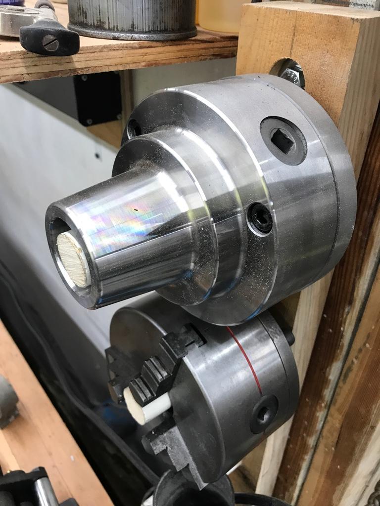

As promised photos of my spindle face and 3J chuck registration. Closest measurement I can come up with on the registration inset is 0.9498mm diameter darn close to 95mm. Still trying to wok out the bolt pattern diameter, every time I do I get a different reading. Bolt diameter measures 7.78 mm. Any suggestions how to measure the bolt pattern diameter correctly?

So the backplate boss lip engages the matching recess on chuck, then insert/fasten caps crews from behind & screw into chuck. Is that the drill?
Is there a chance that 95mm is your boss & 108mm is your bolt circle diameter? if so, might be a plug in for this LMS 5C collet (or clones like them) without any intermediary adapter. The recess depth is shown at 4mm so how does that compare to your plate/chuck? Your bolt is likely M8 & hole is nominal clearance so ~9mm diameter. That probably wont be a precision hole anyways.

Just as a quick check, if I assume the LMS referenced 108mm bolt circle diameter & your measured bolt OD, then you would get this kind of dimension (101.31mm) by calipering across the bolt OD tangent. May not be exact but close. Somewhere in your documents they should probably list or reference this stuff so you don't have to guess at it. I assume most of these machines will follow the same standard, whatever that standard is.

Hey Peter, I shall answer your posts #52 & 53 here.
1. So the backplate boss lip engages the matching recess on chuck, then insert/fasten caps crews from behind & screw into chuck. Is that the drill?
1a. Yes that's the drill.
2. Is there a chance that 95mm is your boss & 108mm is your bolt circle diameter?
2a. Shall check that out tomorrow morning when I'm fresh and can steady myself on my good leg. Your word boss is throwing me off.
Believe what your speaking to is the protrusion on the face of my spindle plate that marries with the recess in the chuck. So the boss
sticks out 3mm.
Note: I'm using a really a nice Mitutoyo 9" OAL caliper but there's times I struggle using it like now.
3. The recess depth is shown at 4mm so how does that compare to your plate/chuck?
3a. Recess depth on my 3J chuck is 5.20mm
4. Your bolt is likely M8 & hole is nominal clearance so ~9mm diameter.
4a. Would agree with you on that.
5. Just as a quick check, if I assume the LMS referenced 108mm bolt circle diameter & your measured bolt OD, then you would get this kind of dimension (101.31mm) by calipering across the bolt OD tangent. May not be exact but close. Somewhere in your documents they should probably list or reference this stuff so you don't have to guess at it. I assume most of these machines will follow the same
5a. Unfortunately my Craftex manual provides no mention of design measurements for my 3 & 4 jaw chucks. Sorry!
I shall measure things up tomorrow and get back to you. Darn weather swings is playing havoc with my right leg/knee and giving me
much trouble so be patient. Hopefully the above answers help!
Your word boss is throwing me off. Believe what your speaking to is the protrusion on the face of my spindle plate that marries with the recess in the chuck. So the boss sticks out 3mm.
Sure, protrusion, projection... works for me. Someone once told me that 'boss' normally refers to (only) circular sections so I might get part marks on this one! LOL
Take care of yourself & we'll pick up again when you have more data. this might not be as complicated after all if the parts fit. The only thing with this kind of backplate arrangement is concentricity is pretty much locked into the chuck itself. ie. if the rear face recess or collet nose is not concentric to your backplate PROTRUSION, there is no real means to adjust runout without more serious mods. No different than other direct mounts but people kind of lump 'accuracy' into one bucket.
I have the same lathe and I am measuring in the 95mm range from the centers of the holes and in the 108-110 range for the bolt od tangent, I don't have mine off I just took measurements with a ruler from the back should be with in a few mm.
@PeterT, a new day and I'm just in from measuring in our attached garage. Of course I understand your reference to boss although not the term we used during my air force days. Can't remember what term was used from our technical aircraft orders although specific to aeronautical terms.
Using my inside and outside spring dividers to measure the registration the boss diameter is 95 mm as well as the inset on my chuck give or take a mm. Boss is 3mm thick and the chuck registration inset a hair over 5mm. Bolt OD tangent is within a whisker of 101.31 mm. With my 8mm cap screws being so short in length 15.40mm and with thread wiggle my reading between the three are 1.145mm, 1.139mm, and 1.124mm. Close enough me thinks, what say you to this?
The clearance between the rear of my spindle face plate and head stock is only 2.0mm so the 23.85mm OAL of my 8mm cap screws barely squeeze in.

Looks to me you have a standard 5" chuck so there should be lots of options out there.
Thanks shall double check to see if I can locate a #4 MT holder for 5C collets.
probably late to the party here, but a 5C collet won't fit in a 4MT spindle taper . Quite a few manufacturers offered a 4 1/2 MT taper which was a good arrangement - it created a taper just large enough to fit a 5C collet. I had a standard modern like that, wonderful set up....miss that lathe.
On one hand an adapter mounted chuck in the spindle is ideal, on the other hand staying with 5C collets makes a lot of sense as they are so common and have a decent capacity. To stay with a 5C you'll need a collect chuck (vs adapter and drawbar) that mounts to the spindle - is it cam lock?
