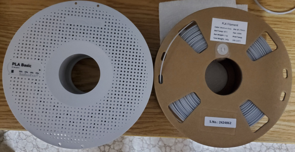

What happened though is when this spool is installed in the AMS and the filament pushed into the drive slot the reel comes to life, turns back and forth a bit and clearly the system reads the RFID tag because the display now shows it installed in A3. And in the user interface it sets up the slicing parameters for the best operation with the filament (as in really fast and still nice).
But wait... there's more. The grey plastic spool on the left had the green filament. The cardboard spool on the right is from Matter3D in Langford. Notice under the label there's a grey/silver dot covered in plastic. It runs across and is the same on the other side.
That first photo in this posting isn't from the left spool but from the cardboard one with the RFID tag. The system thinks it's green and it sets up printing as if it was the green Bambu PLA Basic.
Now if this filament isn't as good as the Bambu then it's easy enough in the user interface to change speed and other parameters etc. So how does the grey turn out if the nozzle isn't all clogged from an odd PETG changeover experience?
Really well. Dimensions match. Finish is good.

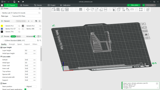

From the software perspective. Create a new project, import an STL file, highlight it on the build plate and select which reel to use. Slice and send to printer. It pops up with sending to printer through the cloud. It's already sliced so I'm not even sure why it has to go through the cloud but apparently that feature can be switched to not go through the cloud.
What it cannot do is import a G-Code file sliced by something else. That's probably why the ORCA slicer is an add on module.

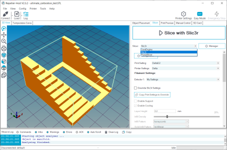

Let's take a step sideways for a moment. The way I used to do it and how I still do with the SOVOL since I don't have this 'klipper' thing on my SOVOL (@DavidR8 has)
In the old days I used the Repetier_Host software and I could slice with any old slicer that created the G-Code. Most of the time I used Slic3r. The Repetier_Host could can connect via USB to the printer driver board and run the printer or just save to a file or SD card.

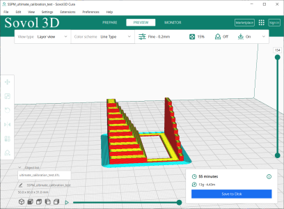

I do the same thing with the SOVOL program and save the sliced file to disk.

OTOH, The Bambu overall is easier to use if I didn't know anything. It's frustrating because I think the user interface is poorly written. Instead of clicking on the part and then way down clicking on change filament I should be able to select the filament from 5 locations on the main screen.
What's also awful is that although the user interface is theoretically in communications with the printer it doesn't know that I loaded new filament that is green. Or, it knows that the filament with that RFID tag has now been marked as grey (which it is).
In either case if I click on the yellow #1 for Generic PLA at a simple level I think the part on the build plate should turn yellow. The chance you'd have two different items on the build plate and go through a filament change for every layer is very unlikely. But that doesn't happen. the filament colours and types don't match the printer.
However from a project perspective if the project is loaded then it fills in what is required for this project. ie. instructions as to which type of filament to put into which AMS slot.

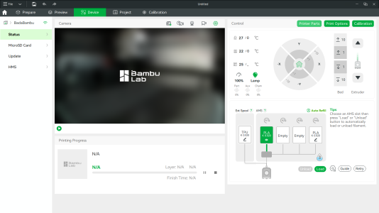

Here's an addendum to the behaviour of the Bambu X1C. I went into the Device Screen. Notice how the A1 spool location shows PLA Green. That PLA was in the A2 location a few minutes ago. I pulled it out, moved it to the A1 location and again the reel turned a bit. And then on the device LCD display the green PLA info moved to the A1 location. Back to the PC application and sure enough it's moved.
So. I believe the 'Prepare' screen indicates what filament to put into the printer while the 'Device' screen indicates what is in the printer.
