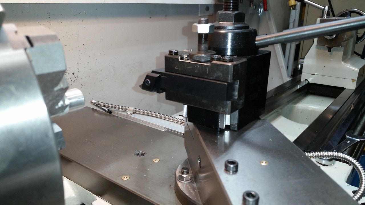

As I mentioned previously, I'm not too happy with the piston style quick change tool post that came with the machine. I ordered a wedge style from All Industrial Tool on eBay. I chose this one as it looks very much like the one I had on my old lathe and the shipping was reasonable. It arrived yesterday and it looks pretty good. It uses Imperial threads (5/8" X 18 on the post) like my old one did and the machining is pretty nice. I had to mill the base to fit my compound and at the same time I disassembled the compound and cleaned and inspected it then drilled and tapped two m5 holes for set screws to hold the base from sliding in the compound.

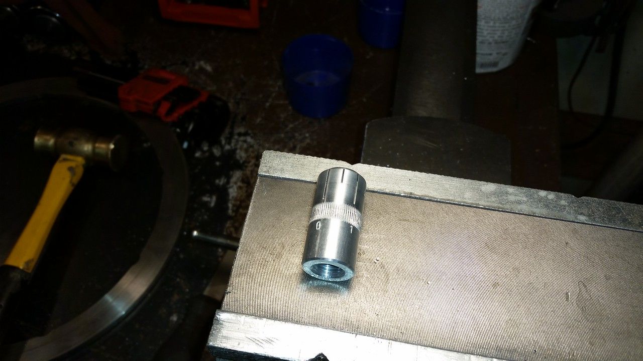

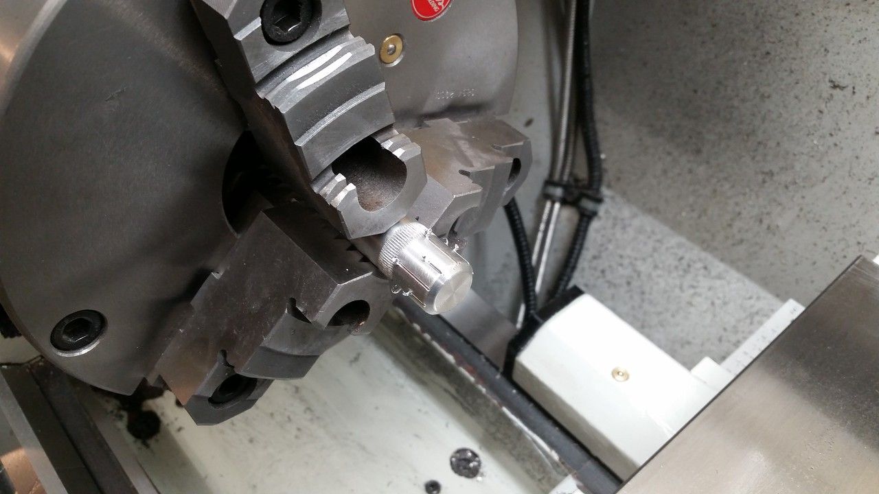

I don't like the bed mounted carriage stop so I made up an improved version of the one I made for my old lathe, which is a copy of a Hardinge design. In the last pic you can see that the old carriage stop prevents the carriage from moving close to the headstock. The new one is much easier to use and is always mounted.
The threads on the thimble are 7/16" 20 tpi so each revolution gives .050" of adjustment. I machined 10 grooves around the circumference of the thimble end, each long groove indicates .010" and the short ones are .005" increments.

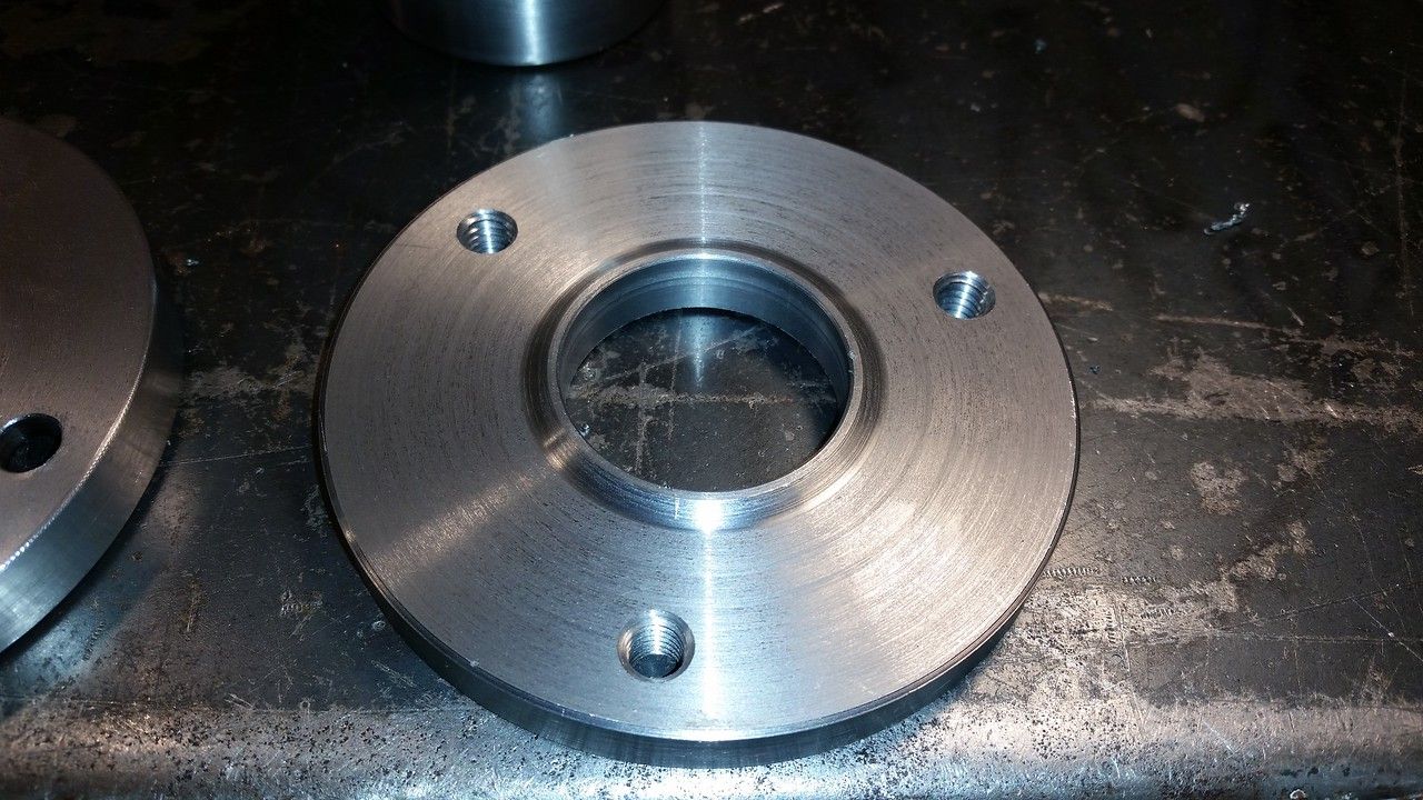

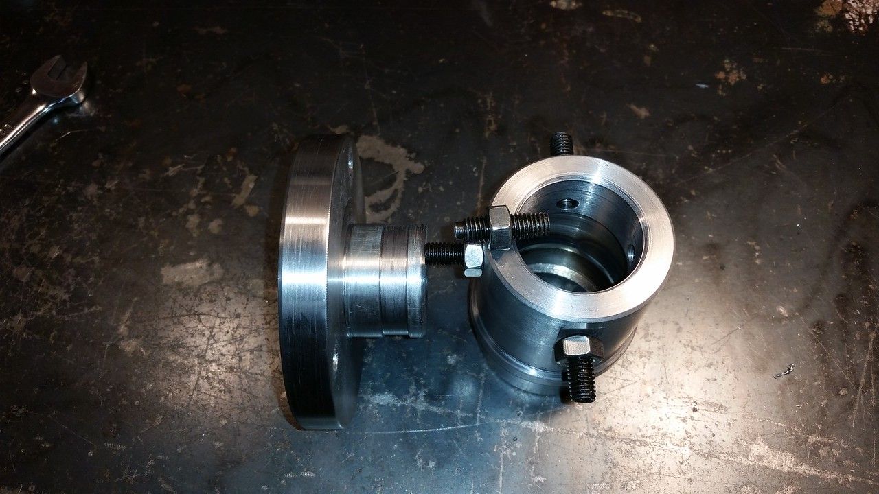

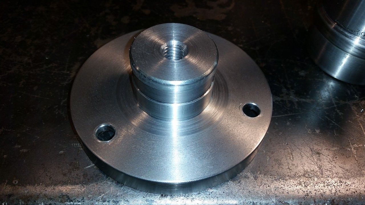

I machined a spider for the left end of the spindle. It has 53mm X 1.5 threads so I single pointed the treads into a sleeve and then welded the new nut to another sleeve with an ID matching the ID of the spindle. It has a shoulder that butts against the end of the spindle and engages 4 threads. I drilled and tapped 4 M8 holes for the spider supports.
Nice.
Dumb question but when you put extended stock in there & its gripped in your main chuck/collet, do you put a DTI on the part extending from the spider to dial it in with the 4 jaw screws? Or is it more just to stabilize from rattling around inside the spindle?

It really depends on how much precision I'm looking for. I work with 1/2" round stock alot and i like to leave the stock as long as possible to reduce waste. Most of the time I'm just looking to keep it from flopping around so I just eye ball it.

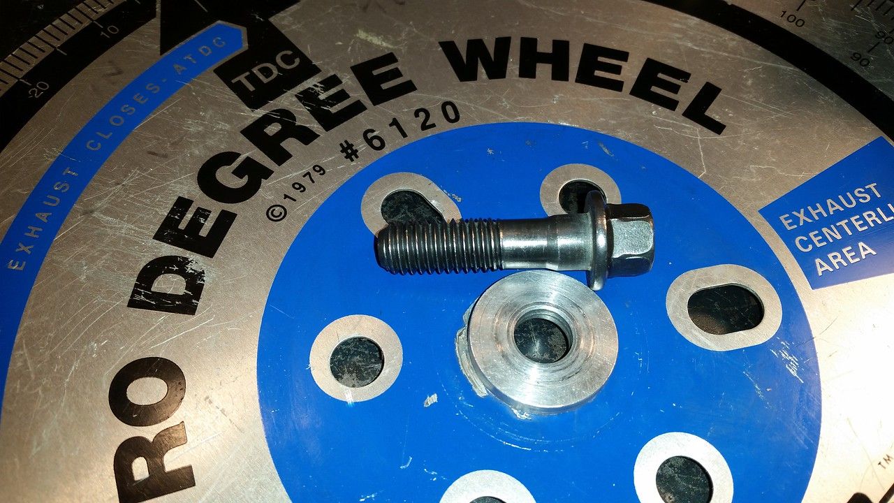

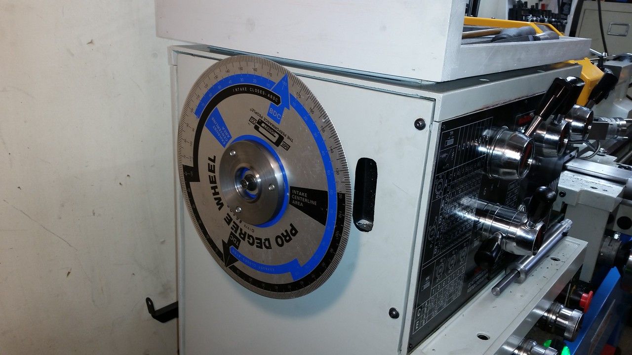

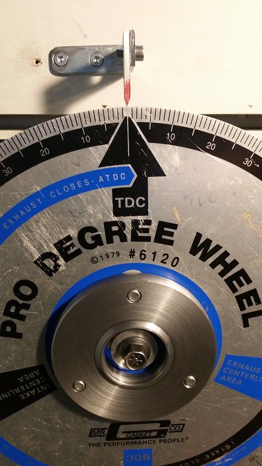

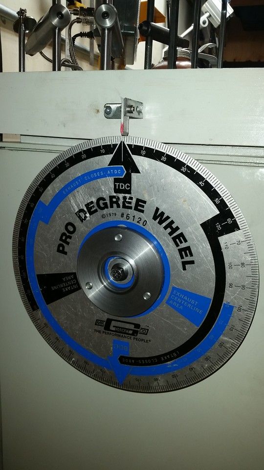

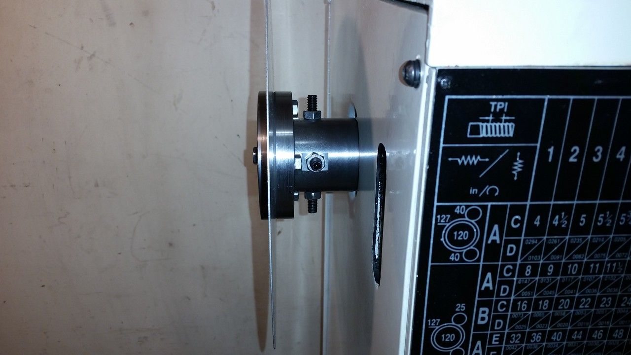

To carve the indicator grooves in the thimble on my carriage stop I made an attachment for the end of the spider. It's just a hub that mounts into the end of the spider and can be set to any position and locked with the set screws. I mounted a degree wheel to the hub and made up a pointer. I wanted to carve a .5" long line at every .010" increment and a .250" long line 1/2 way between each of the long lines for .005" increments. So for 10 lines around the circumference I just needed to turn the spindle 36 degrees for each line. I was trying to figure a way to lock the spindle at each position but it turned out that I didn't need to. I just left the headstock gear box in neutral. Since the cutting force is straight in line with the spindle it doesn't try to turn during the cutting motion. For a cutter I used a HSS 60 degree threading tool turned on it's side and cut the lines .015" deep in three passes. I had to modify one of my tool holders so I could get the tool high enough to be on the center line of the spindle. I used 3/32" stamps for the numbers
