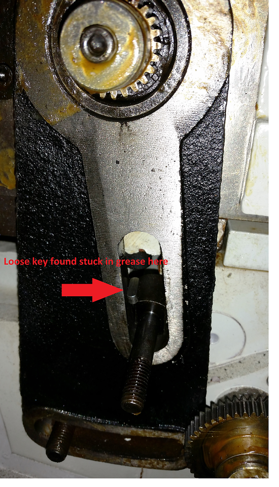

I'm really glad I pulled it apart to do this or it could have been ugly if that key had fallen out at the wrong time.
Makes one wonder what else “has fallen down”.... Like in the headstock, apron, etc.
As PeterT has suggested, good thing you are going through the machine in fine detail, it already is much better than new!

I haven't found anything really terrible yet. I got a call from Modern's service manager today and we discussed the extra key. Based on it's size, 5mm X 5mm X 14mm it is probably a key that was meant for the drive or driven gear since they are that size. We agreed that it probably got dropped and lost during assembly.

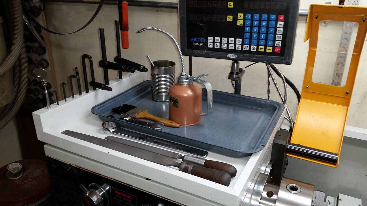

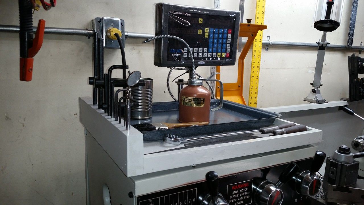

I used my very limited woodworking skills to make a tool storage tray for the top of the headstock. All these tools were just laying on the top cover of the headstock on my old lathe. I wanted to keep things better organized with this one. Made from 1/2" plywood on the bottom and the side pieces were cut from 2 X 4's on my table saw. I really dis-like wood working due to the mess it creates but having that table saw sure does make it easy to cut things straight and square. It's also nice to be able to rip dimensional lumber pieces down to any size you want. Using a vacuum on the dust outlet of the saw helps but the garage is still covered in find sawdust. Anyway, enough whining, the tray is held in place by one of the M6 screws that hold the headstock cover on. I found that Tremclad light grey paint (brush on) matches the color of the lathe pretty well and also Tremclad medium blue is a good match to the lathe base. I usually don't like Tremclad as it takes forever to dry, but it is pretty durable.
