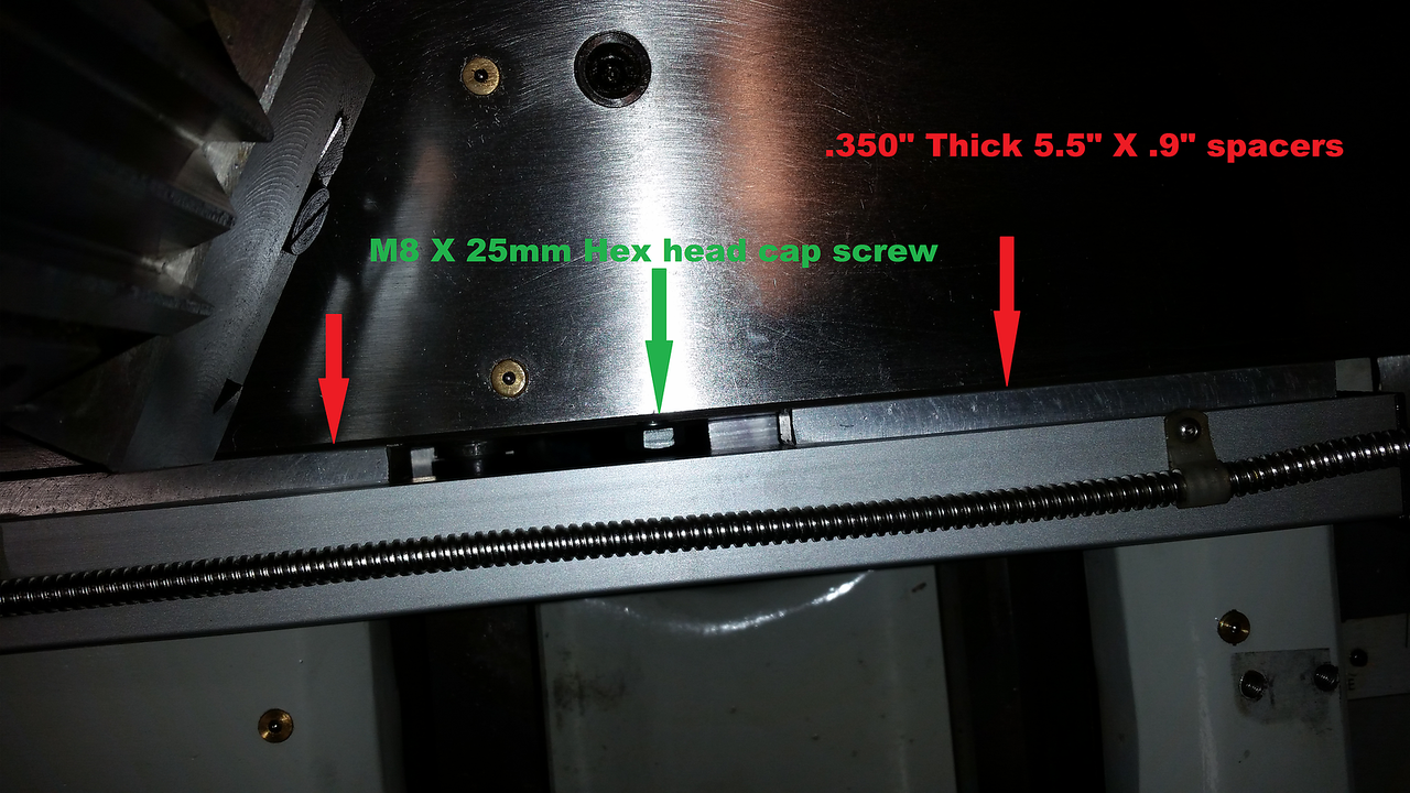

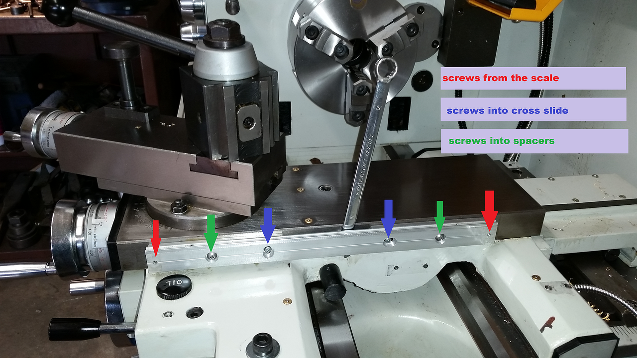

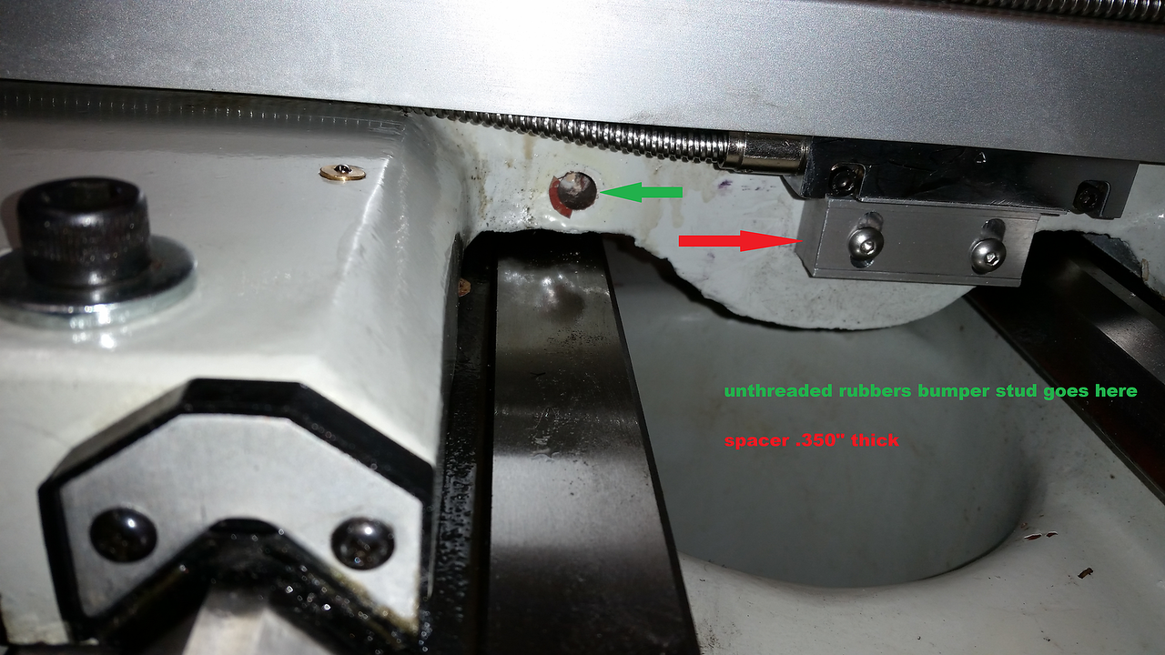

When the DRO was installed the cross slide scale was positioned over top of the locking screw so there was no access to lock the cross slide. That bothered me as I often used that on my old lathe. I removed the scale and machined some spacers to move the scale away from the cross slide .350" and machined an 8mm hex head bolt with a brass tip for the lock. There was just a short socket head set screw in the hole originally. There is also a rubber bumper mounted on a stud and fitted into a hole drilled in the cross slide that is meant to prevent the tailstock from hitting the DRO scale. I hade to shim the bumper out 2mm to make it functional.

Somehow that last pic got out of order but it shows the spacers for the dro and how I screwed then to the original bracket.
Did you make the bolt with the brass tip or is that something you bought?
Can you put up a pick showing the reinstalled scale with a wrench showing how you would lock to cross slide?
My modern lathe is afflicted with the same issues btw -- I'll be shoplifting your ideas and quickly ..... thx in advance
Kevin I actually got the idea for the cross slide lock from an owners manual on the Precision Matthews site. They have had complaints and show this work around in the owners manual. I made up the brass tipped screw from a M8 X 25mm stainless hex head cap screw and some 3/16' brass rod. I made the length so only 2 threads are left exposed when the screw is tight so I could keep the spacers as thin as possible, just enough space for a 13 mm wrench. The brass end of the screw butts up against the gib to lock the cross slide.
Perfect. Picture #1 was what I was after, I wanted to see the wrench clearance
