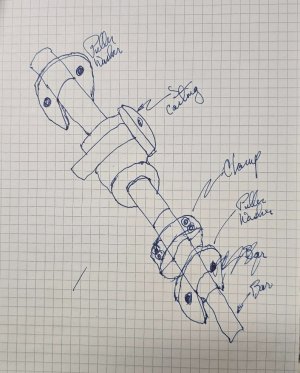

Here is the general idea:
The Fusion guys are prolly laughing, but this is my old fashioned 2D ballpoint pen cad system running with a few missing light bulbs.

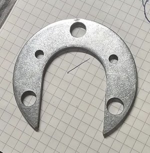

Here is a 2" puller washer I made for an earlier project. It uses three puller bolts instead of two, but it's the same idea. By mounting the clamp on the bar at one end or the other, the S-Casting can be dragged in either direction just by tightening the puller bolts on the washers.
For this job, I'll make my own washers out of much thicker steel so I don't have to worry about them bending. The clamp and the casting should keep the washers from twisting or distorting. The spacing of the two Puller bolts will be set by the size of the casting.

Pencil CAD is the right tool for this tool. Just sign and date the drawing in case it is patentable. That is harder to do in fusion360 🙂

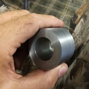

Clamp cut off, OD turned, ID drilled and bored a smidge oversize so the clamp closes nicely.
Gotta tip my hat to @Darren for teaching me to part with courage and conviction. Soooooo nice! Just like cutting butter with a carving knife.
Time to mill, drill, tap, and chop in half. Might put flats on both cap ends to help with bending evenly.

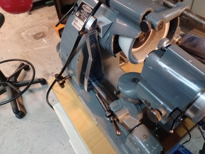

Some part of your device can be used to make this. It replaces the terrible flag on the main shaft. Details in those MEW articles.
We did foliage reduction in the garden this Am so free now.
Looks waaaay better than that flapper/flag thing. More sensitive, better leverage, more solid.

If my Puller won't move it, I'll have to cut it off. But I have huge confidence in the Puller. Better have! It's gunna take me a week to make!

But then again, the clamp is the biggest part of this job. The puller is peanuts to make. Basically just two big fat washers with a cut-out to clear the bar and 2 holes in each for the puller bolts. There is virtually no chance that it will harm the casting and virtually no chance that it won't move the casting. So it's the most certain path forward.
