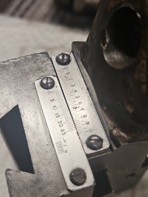

The locking screws should have brass buttons under them, hopefully still there and they fall out. Just be careful with compressed air or they will disappear.
Forgot to mention that sure enough one was missing. The big one. That's also the one for the slide that was most stuck.

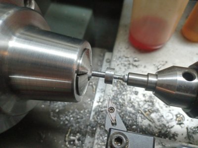

Easy enough to make one on the lathe out of brass. It seems to be an ordinary pin with a flat ground on one end with the same slope as the dovetail.
I prolly would have lost the other one too if you had not warned me. It fell right out when I got the dovetail out. But I was watching for it.

I think today I am going to drain and flush my field sprayer while it is still relatively cool outside, then make a brass stop to replace the one the college lost, and then work on cleaning up the collet holder section.
