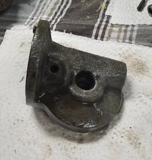

I'm a little late here, but automotive brake fluid will take paint off anything. Soak parts in it for best results.
But you won't have to, this one is for you
Yes, you had said that you would do that and a few other related parts for me! I will be so grateful!!!!
I still want to know how though! It sure looks cool!

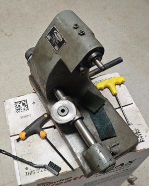

My new to me tool grinder is coming along nicely. Working on getting the crappy paint off of the last component of the gimbal assembly now.
I'll prolly be all done and ready for paint by tonight. Then I need to decide if I want to repaint the main body of the grinder too.
I don't really like the dirty shop green of the current grinder anyway. Maybe a lighter gray or a dark ivory. Whatever colour it is, it will have to be a colour that comes in a rattle can and doesn't require a primer. I hate painting.

To be honest, NOTHING could be worse than what I had when I got it.
All my gimbal parts are stripped down to bare metal now. I finished the last part this afternoon.
It doesn't seem to matter how I look at it, I keep coming to the conclusion that I have to strip down and repaint the main grinder body too. I have not even painted one gimbal part, but I already know I gotta do the whole thing. Crap......

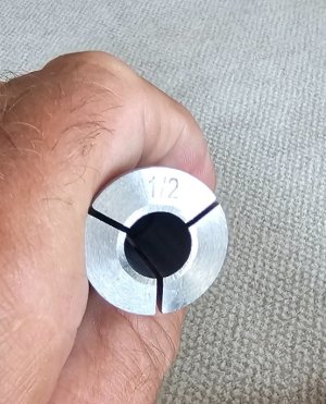

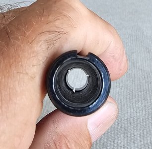

I ordered a few collets on Ali. One 12.7mm (close enough to 1/2") and a 16mm to use with an ER20 collet adapter.
The Ali vendor would not combine shipping so I had to order individually. The 12.7 came today. Guess what? It's actually labelled as 1/2"!
I'm stunned.....
But I'm almost afraid to measure its concentricity.....
It looks pretty bad..... But who knows..... Life buying from Ali.....
