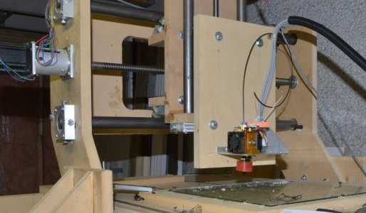

I started trying to 3D print with an add on nozzle to my JGRO CNC router.
That didn't work really well. Needed to heat the glass plate and with decent printing speed the router frame just shook too much. This was back in 2014.

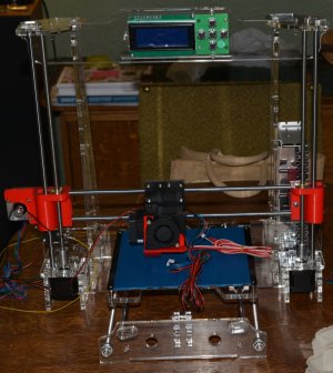

Then I scored this printer in 2016 for $243 Cdn c/w shipping FedEx from Hong Kong.

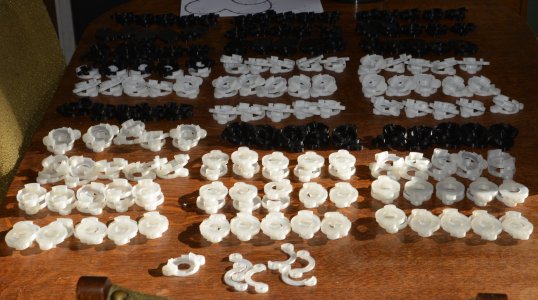

I'm still using this with minor modifications and a RPi2 c/w camera and Octoprint. Not the best but it's been adequate for some fairly big projects like these GE-35 Christmas Light Retaining clips.
And lots of of other things including patterns for casting.
