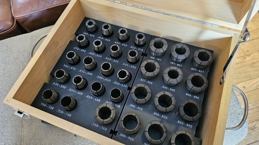

I'd like to tackle a collet rack. And I'd like to make one for 5C collets first since I have so many. Perhaps 30 collets. The tray needs to go in a drawer and not covered. No space wasting labels either.

Can I turn the 25 collet tray into a 30 collet tray without using cad? Can that be done in Bambu's print program?
If I can do that, can I rearrange the holes like a bees wax frame staggered so it's more space efficient using the Bambu printer program? Or is that clearly into CAD territory?

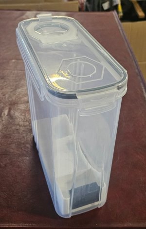

PS - the cereal boxes I got from Amazon came today. The tray I made for the Fillament spool and humidistat fit it perfectly.
Well yes there are some simple boolean operations possible within the slicer. I haven't tried this for a while so maybe others can chip in.
The block can be cut with a planar slice to produce a single row of 5 holes. This part can be copied and arranged alongside its mate to make a 6x5 arrangement.
An STL file is a baked polygon mesh, not a parametric feature tree. The existing 25 holes are permanent geometric voids. You cannot select and move them with the slicer.
The overall scale can be changed in X, Y, Z together or independently
You can create primitives such as a cylinder (or a negative shape cylinder = a hole) and position them.

p.s. so you could for example download the STL of a 5C collet and use that as the negative shape to punch the correct size holes in the block, using pattern replication.

Humidity control is top of mind. In fact my second print job was a spool tray with a place for a hygrometer, and bowls for dessicant that fits in the bottom of sealed fillament containers (cereal containers).
Labels are obviously nice, the collet rack in your photo looks top notch. In fact, gorgeous might be a better descriptor. But, most of my collets are already marked on their face, I don't mind a bit of size testing, and I need the drawer space much more than I need pretty. Therefore...... no labels.

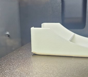

I don't have the patience for that, I just remove the build plate and flex it to get the part to release. Sometimes it needs a little help.
I also remove the build plate and then set if on the metal tablesaw surface making sure it's completely wiped clean so nothing sticks to the bottom of the plate.
That cools the plate really quickly and shortly after that the part pops off easily.

Speaking of bed adhesion, the first time I printed TPU I destroyed the part trying to get it off the plate. Always use the smooth plate for TPU. Even then it can be challenging.
