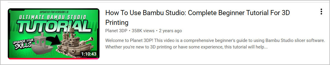

I recommend this guy (filtered on 'Bambu'). He gets to the point & is quite throrough.
probably start with this one

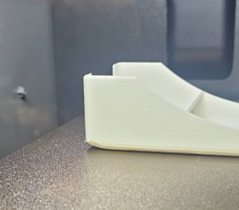

Finally done the bottom and printing sides. The rounded bottom is causing the corners to lift a bit. Not yet sure if that is a problem.
There are various solutions to corner lifting. Generally some sort of glue. I 'borrowed' my wife's hair spray and periodically pull the tray out, give it a light misting. Seems to work well with PLA. Too well with PETG. Another reason for being able to place smaller parts on various places.
Anyway there will be lots of opinions on corner lifting.

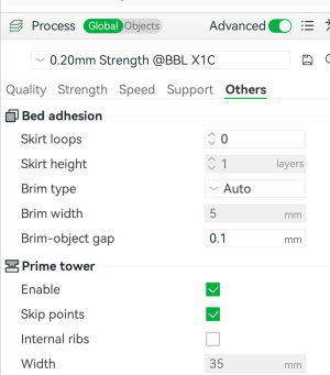

In Bambu studio go to the panel on the left and click on OTHERS, Under BED AHESION, click on BRIM TYPE, OUTER BRIM ONLY.
This will print a removable lip around the outside of the object that generally helps tp keep the piece flat. Letting the part fully cool before removing from the print bed helps as well

Thanks. It actually turned out ok. Done right on schedule.
I think it might have even been an optical illusion. The corners are rounded - prolly to fit the cereal containers better.

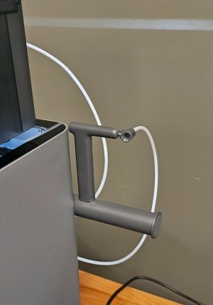

Another quick question. Now that I know that those tubes are just filament guides, is there a reason I can't remove the manual spool holder?
I can't really imagine needing it and it looks like a Susquatch trap. It gives me the heevie jeevies. I'm gunna get it caught in something and either break it or break something else.
It's magnetic, and pops right off....it's designed to flex, just don't get too squatchy with it......
That's a real risk....
I was working on an impliment hookup a while back and my wife happened to be there. It wouldn't quite go so I wound up and stomped on it. My wife just about fainted. She had never seen me get violent before.
I bought a spare with the printer. I'll check it out first.
