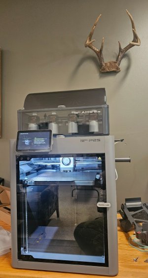

Today was unboxing. Here it is setup and doing its self calibration thing as I write this.
I have not done the benchy yet and can't really comment on any printer strengths until I actually use it. The setup video is ok, but nowhere near perfect - it flat out misses a few steps.
At this point my biggest gripes are:
1. A REALLY LENGTHY process of removing tape, packing foam, and unscrewing things with a supposedly magnetic Allen wrench that was definitely not magnetic enough to reliably extract the screws.
2. Instructions to install two dessicant bags - way too early for that! Don't even have filament installed yet. Surely the built in dryer isn't just dessicant....... If so, those tiny bags will need serious upsizing.

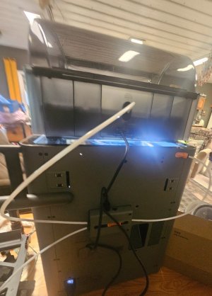

3. Ugly little filament control tubes everywhere - surely they can do better than that!
4. The printer wifi didn't like the wifi subnet in my barn. I had to redo my network so the printer could call home. That also required a startup reset with no instructions on how to do that and no way out. In the end, I just unplugged it and thank God it started over.
5. It's really amazing to watch it evaluate the in-place natural frequencies. Also quite obvious I need to change the stand/desk. It's plenty strong but not nearly rigid enough. When that head dances, so does the table. It will be interesting to see how well it eliminates resonance in use.
So far I have not needed to know anything. Just follow the instructions.
Tomorrow I'll try to print something.

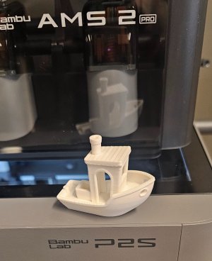

One Matt Ivory benchy in process. Says 20 minutes. Most of that seems to be calibration and bed levelling.
The fill squirts are brutal. Printer oscillates a good inch. Doesn't seem to matter. The head knows where it is. The main benchy is looking great.
Anybody know where the "swarf" goes? I know it's making some but it disappears inside someplace.
There is also a "test" line separate to the benchy at the front of the bed. What is that all about?
The printer poop spits out the hole at the rear of the machine. Some folks print poop chutes to direct the bits into a bin.
The line you see at the front of the build plate is a priming move for the head to make sure theres filament extruding when the print starts.
I see that now! It's all on the floor behind the table the printer is on.
Yes, a collection pot seems appropriate.
How do I know when to remove the benchy? Is there a process?
The PTFE tubes all need to make fairly gradual bends or the filament is too difficult for the extruder to push and pull. Bad things can happen.
Oh, I see! Those tubes feed the filament to the print head? Ok, I thought it was compressed air or something. I guess it's ok if they carry filament.
