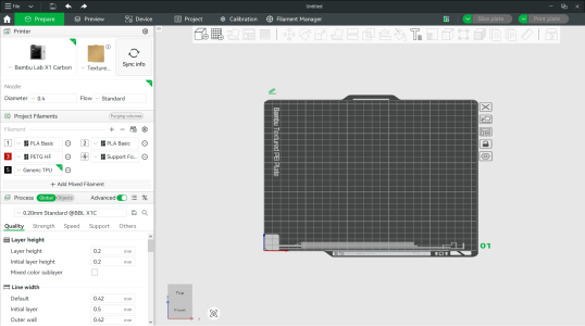

Have you got a connection from your PC to the printer via the Bambu desktop application? Should be here:
"C:\Program Files\Bambu Studio\bambu-studio.exe"
You can put an icon on the desktop:
When you run it you get this:
You select what model printer and the type of print bed. Smooth or textured. They usually come with textured.
When you click on the sync info it will read the RFID tags on the reels in the AMS and fillin the filament list. #1 will be the default printing choice.

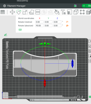

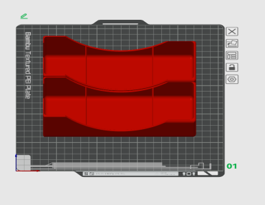

Anyway, File, import, the STL file is usually easier if the 3MF was meant for a different printer. This way it uses the default values. When the desiccant tray is loaded it's on its side. So you select rotate enter 90 degrees. If it's the wrong direction enter 180 to flip it over.
Next with the item highlighted with the solid line do a right click or Ctrl-K and clone one more so you can print two of them. (if you want to try that right away).
To arrange them for better printing motion select the 4th from the left to arrange the parts. Makes sure none are sitting on top of each other.
Now if you right click again on each item you can change the filament from the default slot #1. Easier to do that before you clone them.

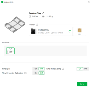

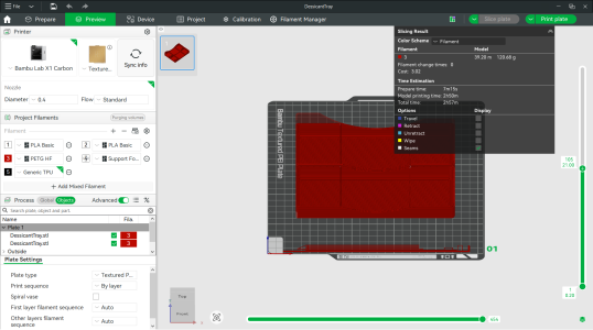

Above is an example of PETG RED. The click on the slice print button on the top right
And we see it will take about 3 hours to print this. So now click on send the print plate button.
If it's the first time you are using this filament between power cycles set flow dynamics on and bed leveling on. Although theoretically the Bambu filament doesn't need the flow dynamics where some other cheaper PLA will.
Once you've done one print you can set all three switches off. Click on send.
At that point it will tell you that it's being sent through the cloud to your printer and assuming you have all that network stuff connected it will start heating the bed and then the extruder and then load the filament and do the prelim stuff.

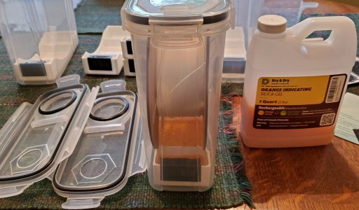

And when you have the trays printed and you've received your cereal boxes etc...
pour some of the indicating desiccant into the 3 spots on the tray and lower it into the cereal box. Then set the reel on top of that and close up the box.
This Elegoo spool of PLA had already spent some time in the dryer earlier today so it was even still a tad warm. When I inserted it the RH was 50% and 19.5 degrees (cold in the house at the moment).
Now 30 minutes later it's at 10% RH and 20.6C.
Assuming the box doesn't leak I'm going to guess it will stay at this for quite some time.

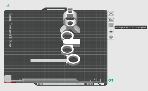

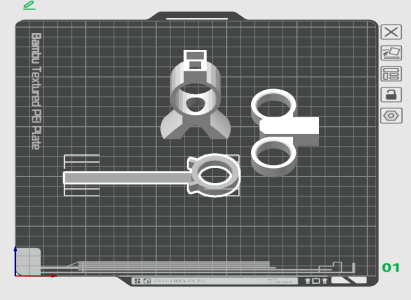

For example these 3 parts make up a cherry pitter which removes the pits so the cherries can go into a canning jar with some booze. Here below I've just dropped them on the plate and moved them so they don't sit on top of each other.
And if I click on the arrange button 3rd from the top on the right there the system puts them in what it thinks is an optimal position for print speed.
Dohh. That was kinda obvious. Brain is slowing down daily now. I wondered why the benchy was so far over in one corner.
How about rotation? How do you control what surface is facing down on the plate?
