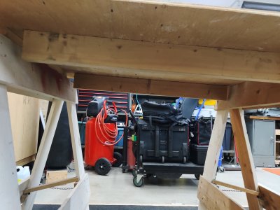

Now I can use the saw horses to make a quick light duty work table (gaps at top of saw horse allows 2"x2" to drop in between for easy set-up and the 2"x4" gives the 1/4" ply some added support):

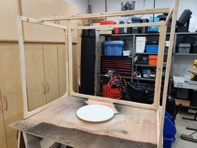

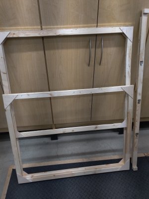

Next, a fold-up out frame which is normally covered with poly to create a small "paint booth" for spray painting small items (complete with a board above for hanging items and a rotating table for other paint items):

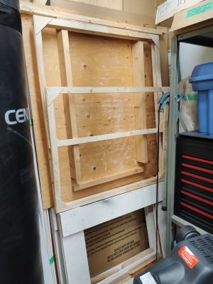

When done it all folds up and stands in a corner:

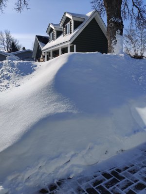

Peaking over top of that pile is the kid's playhouse and our garden shed. Slowly starting to run out of room as I try to keep a buffer between the snow piles and the house.
