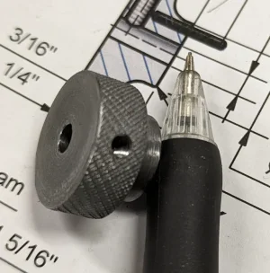

Meanwhile, after a bit of swearing at my knurling tool:

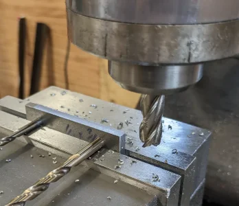

And then mid-way through this little support arm:
The taper came out fine, though slightly off-center. I must have mis-aligned my hole centers fractionally, which might mean I wasn't fastidious enough setting up to drill them, or that I really do need a set of gauge pins.
Next will be to bore those out larger, one 3/8" clearance, and one for 1/2"x20tpi threads.

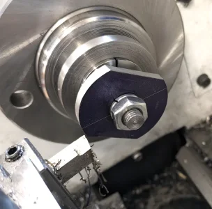

Ok, I got the pin "done enough". First step was the fat end:
I was worried about this, but I guess I shouldn't have. Trammed it in easily, and then it cut directly on radius.
Next was running @thestelster's procedure, for which I had a ton of extra stick-out to test diameter with. It was clear that this part is flimsy enough that a second pass wouldn't work.
But even after adjustment it still wound up 10 thou under sized. I don't think it will affect the application:
If I need to, I now have all the know-how to make it again.

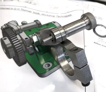

So I got to complete the indexing plunger and its supporting arms and brackets. The plunger tip will get timmed back once I have the main gear drilled.

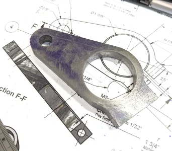

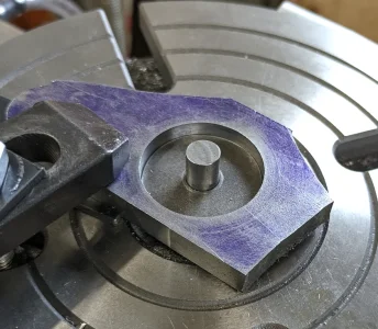

A few bits of the work. The bracket was fun rotary table work - a 3/8 centering pin to work one radius, then a 1 3/8 disk to sit on the same 3/8 pin to index the larger hole.

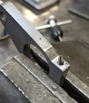

I got one surprise when tapping the closing screw. At least it had the good taste to stick out enough to grab it with vise grips:

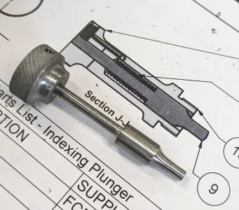

The rest of the plunger assembly held no surprises at least:
I'm not in love with my surface finishes. I'm going to have to become more patient there.

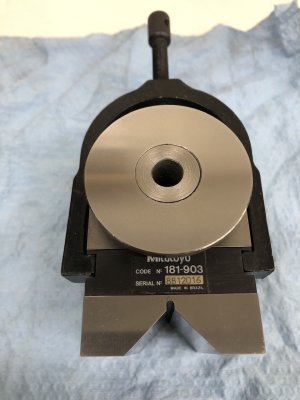

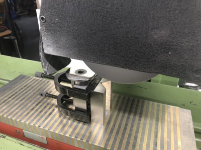

Some teaser pictures: base turned and 1. partially ground & 2. finished ground. (Material is “metal” - no idea what kind; not hardened).
(not yet Mitutoyo quality, but getting better…)
