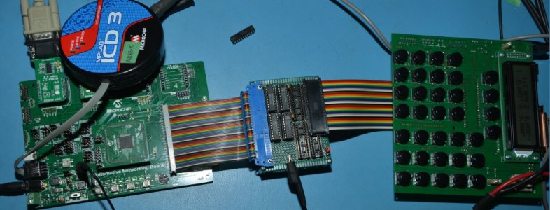

I ported the 8 bit C code into a PIC32 with almost no effort. The interrupt routine that deals with checking ESTOP, runs the on board Micro-Stepping driver, does the trajectory motion changed from taking about 35uS to just over 3uS. A 10x improvement.
All I needed from the development board was an adapter that translated 3.3V signals to 5V signal levels and moved pins around to match the original 40 pin DIP processor. Ignore U2 and U3 as those are the empty sockets on the board.
For testing the ICD-3 programmer/debugger let me insert break points to stop inside the interrupt routine and even single step the assembler language.

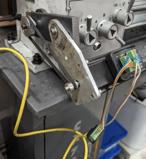

Ok, got a bit more time to poke at my setup, which was reporting slower RPM than the readout on my lathe. So I hacked my way around the physical limitations of my
"count by hand" method. I present you the Kludge-Omatic-RPM counter:
zer
I scabbed a momentary switch onto a PCB I had lying around and zip-tied it to the standoff that holds the cover over change gears, and the lock nuts that space it hold the zip tie well enough to have the little magnetic standoff I put on the spindle pulley very reliably hit the switch. That signal goes to my little Saleae Logic analyzer which is also counting the pulses coming from the encoder hiding behind the gray wheel in the upper left.

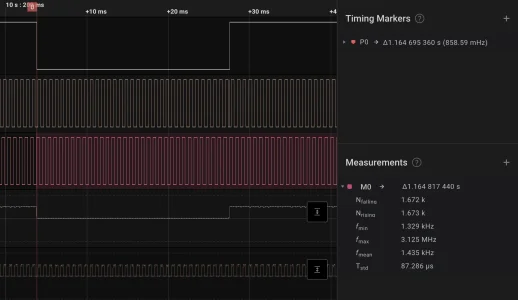

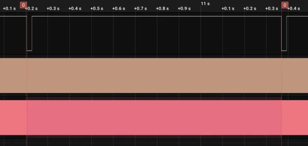

The brown and pink bars are the encoder signals - here's a closeup:
The quadrature encoding is clearly visible - the two pulse trains are offset by a half wave. And on the right the nice machine has counted up how many pink edges there are between successive rising edges of Kludge-Omatic input. Checking a few intervals I'm at 1675 +- 3. I'm going with 1675.
And I can see that my little gray wheel is slipping agaist the belt, quite reliably differently at different RPMs. Which isn't surprising - it was a quick cheap hack to get the encoder hooked up. Time to machine a real bracket and pulley. The geometry lets me run it off the drive pulley - I rarely (as in have never) run in the high range, so I don't feel bad committing that belt groove to the task.
View attachment 29138zer

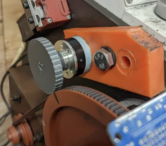

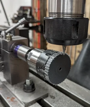

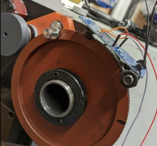

Ok, I got a new encoder gear milled up, and moved it to rest on the spindle drive pulley, both at @jcdammeyer's recommendation:
I was able to cut the teeth with a 2mm end mill using my indexing jig and the 40-tooth changegear from my lathe on my indexing jig I made a while back:
To date, seems to be less slip, but when I adjust the encoder-to-spindle pulse count to match the lathe's displayed RPM at one speed, I get error at other speeds, indicating a non-linearity somewhere.
The RPM display on the lathe is very laggy - I don't actually trust its output. Next step will be to fit on the opto-coupler that John gave me so I have an index signal, and can use that to get a real RPM count and know I'm measuring the spindle speeds correctly.
And maybe replace that block of orange plastic with some nice aluminium - the plastic deforms more than I like while putting even minor pressure down between the pulleys.

Is it possible that the X:Y multiplication in the pulley sizes is overwhelming the encoder inputs on your RPM measurement? Say the encoder is 800 lines then in quadrature that's 3200 edges per rev. But the encoder is being turned with say an 8" to 2" diameter pulley? (I'm guessing sizes). So that's now 4x the edges per rev.
Unless the v belt is slipping and the teeth in your plastic pulley mesh and there isn't an anomaly in the back side of the belt somewhere then there shouldn't be any slipping. But dropped counts are possible.
When you get the 1 PPR sensor working I can bring over an ELS to read the RPM. And of course your scope can show period.
Edit: Changed seconds to revs. so 12,800 edges per rev with an assumed 1:4 step up ratio. If the spindle is turning 360 RPM then that's 6 revs per second and 76,800 edges per second or about 12uS per edge. That's not a lot of time to count edges although that TI processor you are using could do it in hardware.

I think the scope will be your friend here. The period from the 1 PPR will tell you RPM. The frequency of the encoder output will tell you your ratio and if it's jittering or not.

Sounds like lost counts or count/edge deterioration . As others have said, a standalone counter that is polled to get the count is a superior way to do it. Hence my own desire to directly access the Arduino counters and bypass the Arduino interface.
I agree with @jcdammeyer. An oscilloscope is your friend if you have one. If not, use a handheld laser tach and put a full wrap of black tape on the shaft you want to measure as well as a small piece of reflector tape. The black tape will improve signal to noise ratio.

According to the Clough42 Electronic Gearing code documentation the RPM is updated 2x per second.
Uint16 Encoder :: getRPM(void) { if(ENCODER_REGS.QFLG.bit.UTO==1) // If unit timeout (one 10Hz period) { Uint32 current = ENCODER_REGS.QPOSLAT; Uint32 count = (current > previous) ? current - previous : previous - current; // deal with over/underflow if( count > _ENCODER_MAX_COUNT/2 ) { count = _ENCODER_MAX_COUNT - count; // just subtract from max value } rpm = count * 60 * RPM_CALC_RATE_HZ / ENCODER_RESOLUTION; previous = current; ENCODER_REGS.QCLR.bit.UTO=1; // Clear interrupt flag } return rpm; }
That parameter RPM_CALC_RATE_HZ is 2 and ENCODER_RESOLUTION is 4096 so
300 RPM would be 10,240 counts in the encoder register every 0.5 seconds. This is 1:1 from spindle to encoder which has 1024 lines for that 4096 edges.
Now if you had an 800 line encoder with 3200 counts per rev with 1:4 ratio to the encoder from the spindle the value for encoder resolution is 12,800 instead of 4096.
Now the code above shows testing for overflow and 32,000/2 is still larger than 12,800 but we haven't actually spun a full scaled encoder rev. Just too fast within the time period I think.
Unless I've screwed up on the math. I suspect the RPM measurements are overflowing.

Ok, you've convinced me to check out the overflow handling in detail - yeah, my 600 step (2400 edges ) encoder spinning at ~1700 steps (6800 edges) per rev will overflow a 16 bit counter at as low as 8rpm when sampled every 2 seconds. The symptoms are a off though, as I'm getting within 5% over my whole speed range.
