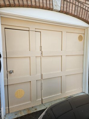

I have these vents I put into my garage door. I printed them out of PLA but the colors don't match. I'll try the primer and latex over it. I don't expect them to last more the a couple of seasons, but I brought them into the world and I cam just make more.

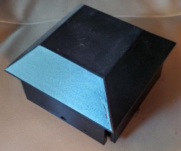

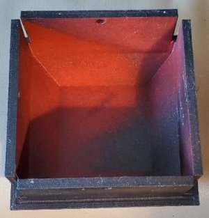

OK. Red PETG. Painted first with primer
and then with the Rustomleum.
Looked pretty good when I put it on the fence post near the end of May.

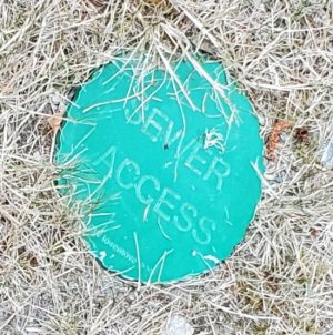

It sits in direct sunlight where it gets very hot. Notice it's cracked.

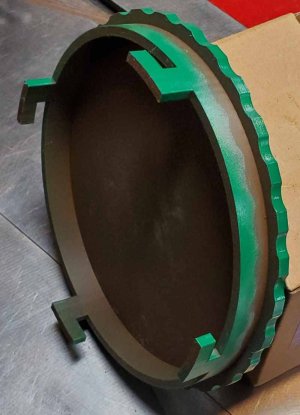

OTOH, This printed in PLA and primer and oil based green paint. Also end of May but a year ago.
I've noticed because it's cold underneath due to the hole and sewer cleanout and hot above from the sun that it tends to warp but overall after a year it's still in great shape.
20260814_093136.jpg.
I'd have to print a fence cap out of PLA and use the same primer and paint to see if it would also crack. It sits loosely on the post. As in the post is smaller than the opening.

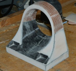

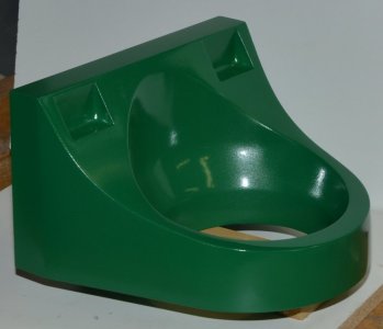

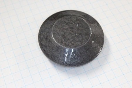

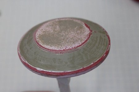

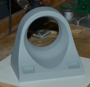

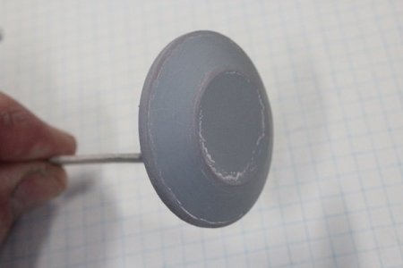

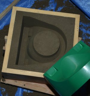

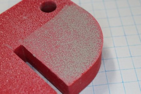

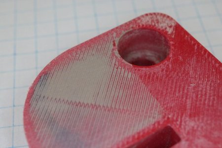

I didnt take many pics of my finishing, I only do it when I have to. But these were in my album showing filler, primer & HammahTime spray bomb on PLA. When I use 3DP to make molds with better finish, its pretty much like this process. Usually when I have excess paint from whatever I'm working on, I'll throw some on scrap 3DP part just for shop R&D. PLA is typical plastic challenges 'sticking' is a relative term. If its not seeing rough duty or wild temperature change, it stays put reasonably well. Hydrocarbon based poducts stick better than water based, at least ones I've tried. I have some Tamiya 'plastic' spray bob stuff I should give that a go one day. There are all kinds of paint products the plastic model crowd uses, moreso water based these days, but of course kind of niche to their application
