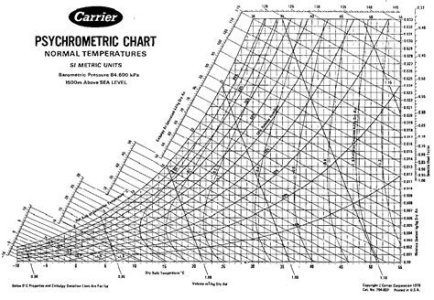

Ya, that's true. Although the difference is night and day, rust does occur even without dew. Our testing showed that different metals and different surface finishes react differently at various relative humidities. As @jcdammeyer points out, the trouble with using relative humidity is that's its only valid for a given temperature. 60% might be fine at 70F, but as the temperature falls, the relative humidity sky rockets.
Here is a psychometric chart for anyone who wants the details. I taught engineering thermodynamics at university so I'd be happy to help anyone who wants to dive in.
Even so, some metals and metal surfaces will start rusting even at low relative humidities.
That's why my shop is dehumidified to 45% across the full range of operating temperatures, and why I keep the temperature above 45F all winter long.

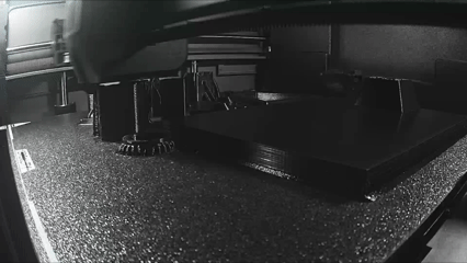

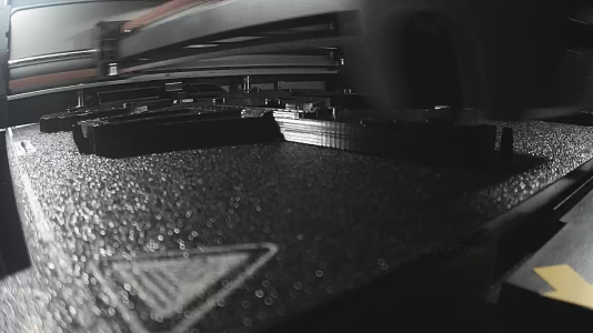

Printing the adafruit heat insert press. I had all the parts here on hand so was a quick little print last night and I have it assembled here today> I did have to design and print a holder for my specific heat iron.
I didnt know the forum app would accept GIF. Is that the native format of printer camera or do you convert it in a video app, like MP4 to GIF?
I used clipchimp, original mp4 was stupid big and in 4K. Who needs 4K for vids of 3d printing? First time using clipchimp went really easy. Way easier the using some of the online converters.
