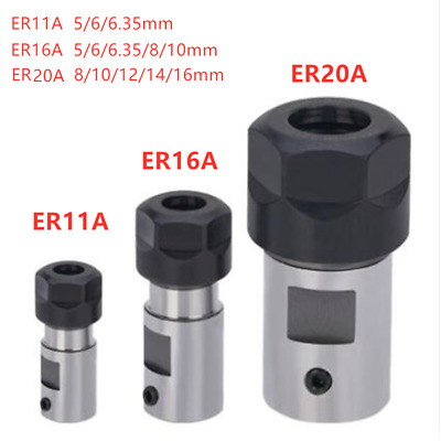

Are ya thinking of going original motor then? The three I had picked out were:
2.5hp@4000 same as ebay motor
2.25@3150 johnson same as original
2.5@5400 less torque
It sounds like the original might be your best bet, no adapting a lh thread to some sort of collet...
