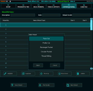

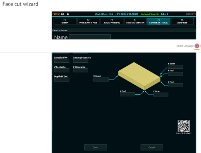

Re the handwheel question: this was a big one for me, and honestly what was stopping me from converting my mill. In the end, I won't have handwheels.
What I learned/realized at John's shop is that simple ops that one would do with handwheels can be easily done with an MPG or G code commands into the MDI.
The Masso controller I'm using also has wizards for common ops.
Here's a screenshot of the face cut wizard.
Very much like the MACH wizards.
