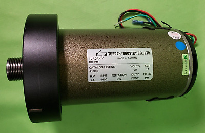

This is the video I found.
A quick eBay search revealed this one:
Not sure about $100 for a treadmill motor, there's probably a couple of dozen treadmills for $25 or less on Marketplace Victoria

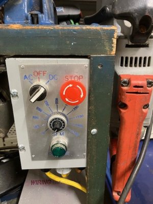

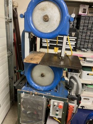

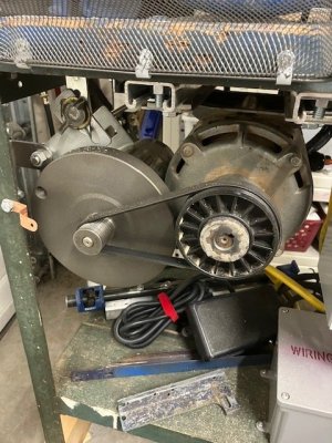

And if you want a truly bizarre example, my 1936 Cratfsman bandsaw has two motors - 3/4 HP 120vac 1750 RPM fixed speed, and a 90 VDC treadmill motor with KBB controller. No pwm, I just use a pot for speed control. Treadmill drive belt and pulley connected to AC motor. One end of AC motor drive shaft connects to the treadmill motor, other end has the pulley to drive the bandsaw input pulley. Interlock so AC motor and treadmill motor can't be powered at the same time. Simple sliding tensioner on the treadmill pulley so If I want to use the AC motor I just pop off the treadmill drive belt.
Variable speed works great for cutting metal.
Custom Staples office tray belt guard.
View attachment 53878View attachment 53879View attachment 53880
I love that! Very clever and now you have got me thinking about my own bandsaw...

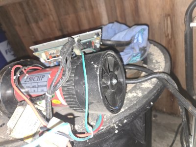

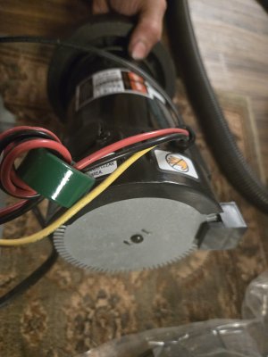

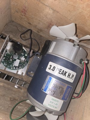

Ya I collect em. Pull the driver board when I do. They vary in diameter from about 3-5 inches, may or may not have cooling fans on one or both sides of the shaft and may or may not have a rotary encoder or rpm sensor.
That ones nice, no fans and a wheel encoder, about 4 dia.
Heres a couple smaller ones approaching 3" dia, no fans
They more often have fans
I hit up the dump or buddies when throwing them out or see em for free. Recently stopped collecting because i have far too many. Also have a few incline motors. Cost of shipping and you can have your pick.

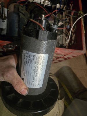

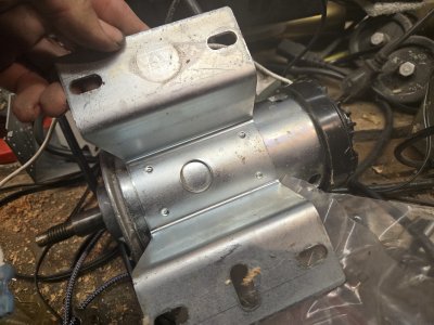

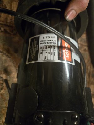

These ones look promising.
Particularly the silver one, stamped 12492.

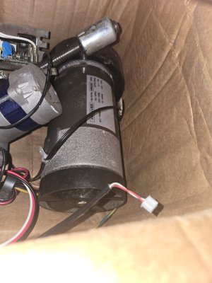

I would need to see the shaft end of the other two if you have pics.

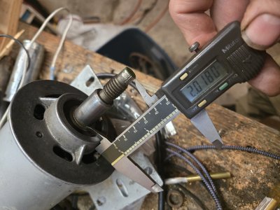

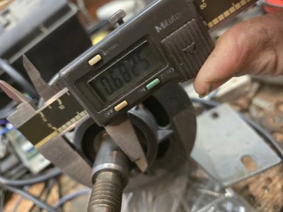

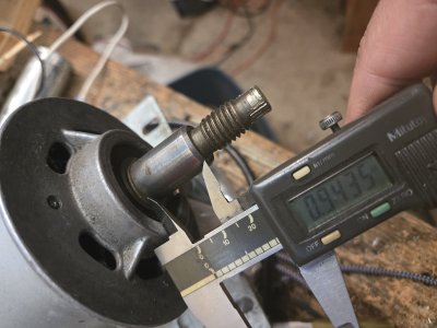

12492 is 3.170 dia body, the mount bracker is spotted to the body. Dimensions in pictures
1/2-13 LH one shaft. The others Id need to pop the flywheels, I can do that tomorrow for ya, are there specifics youre after? I think threads are usually LH...

That's great!
Basically looking for minimum 1.5 HP, 2 is better.
Longer, larger diameter shaft for ease of adapting.
I'd probably make an aluminum 'can' for the shaft end to drop into for mounting purposes so a round housing is ideal but the spot welded bracket could probably be dealt with.
Only big concern is the treadmill motors tend to be higher rpm than ac motors, so you need to consider this when setting up the drivetrain.
They need extra cooling consideration when run lower. Davids gonna do some homebrew water cooling though I bet. 300rpm for 8 hours straight might cook it. Gearing down would help/alleviate. Something to think about.

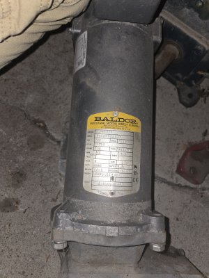

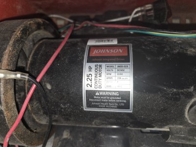

So ya I dont quite follow the hp ratings, some are rated at 4000rpm some 6000.
Like this one seems alright, 2.25hp continuous, at 3150rpm

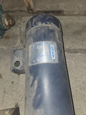

But what I dont get is I have a Baldor 1/2hp at 1750rpm and its bigger than all these
Also have a monster leeson 1hp 1750 rpm must be 6 dia, 18 inches long...
