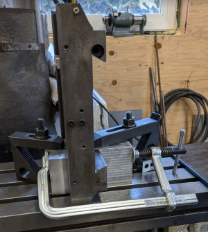

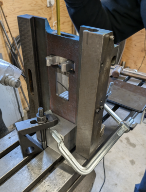

I needed to mill out a slot in the Y table for the x-axis ball nut.
Since my mill is in pieces, @PaulL came to the rescue.
His huge First mill makes mine look like a KitchenAid mixer! Very nice machine. I can see why there’s so much love for big machines.
Anywho, we got the slot milled out.
Double ball nut fits perfectly.
We had to mess around a bit with tooling to find something long enough to reach the slot so we could lengthen the slot for the M8 cap screws.
A counter bore makes a fine side mill if used carefully. Good thinking Paul.
The main challenge was standing the carriage up solidly:
Fortunately I had a 2-3-4 angle plate nice and square, and a second 2-3-4ish block I'd just finished squaring. Between the two we were able to sandwich the carriage between them and anchor it. We just had one poor moment in which the filling attempted to pull out of the sandwich, leading to a quick clamping change to move the right hand clamp over the dovetail edge and re-zero-finding the slot.
