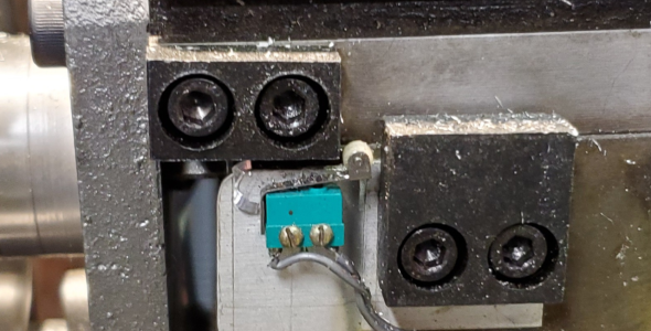

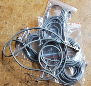

The only thing with having the sensors inline with the travel is if you're machine ignores the stop or you over ride it for any reason and you fat finger the direction you're going, you break the sensor or its mount. Now the nice thing here is the mounts are 3D printed so its just a nuisance, nothing to cry about, unlike crushing a proximity sensor between 2 solid masses... :eek:

Yup been there done that on my cnc router.
I have a fail safe for the X and Y in that there is a physical stop on the negative end of both axis. I'm going to adjust both axis so that the prox sensor triggers just before.
On the Z, an over travel would likely tear off the mount.
On the plus side because I'm using servos, as soon as they lose a step they throw a fault and stop.
Also using NC switches so that helps prevent an accident too.

I too have hard stops that physically stop the travel if the limit switch fails which is also NC so if a wire breaks it's the same as the switch tripped.
I've thought about positioning the switch so the metal moves over the top of it into the mechanical stop. But haven't tried to see how sensitive or repeatable that is. And repeatability is what it's all about.
