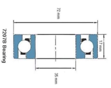

I'm a bit muddled in my thinking here. What is the bearing orientation that is required?
Me thinks that the top bearing should be like this so it can resist downward pull when the servo motor is pulling the head up.
And the bottom like this to resist upward force when the servo is pushing the head down.
I need help on this one. I think the top bearing may have been in upside down because what was left on the end of the ball screw was just the inner race.
So are the bearings in 2 pockets with a step between them? If so there needs to be a spacer bush on the shaft for the inner races to keep them from being overloaded. Its not the best arrangement, as the tolerances are usually really tight, hence the reason angular contact bearings are sold as matched sets, or universally matched sets that can be installed with the correct preload.
Agree with Slow-poke - replace with 6202-2RS for now, you'll have a small amount of backlash due to it but should be manageable. Really what you need to know is the size of that step so you can make a spacer bush to control the preload, probably something in the order of a few tenths to a thou less than the step size (thats a total WAG).

Is my thinking correct on the direction of the axial forces?
(No idea why I'm struggling to picture this in my head)
They can be either back to back or face to face for bi-directional force which is what they will see in this application. This link has more than you ever wanted (or needed) to know about the bearing arrangements: SKF Bearing Preload
That said, with the ballscrew being a relatively long and bendy thing compared to say a lathe spindle, stiffness of the bearing arrangement to off axis loads is probably irrelevant so either way is probably "right".
But if you put them back to back then you won't get as many haters screaming at you online that you did it wrong.

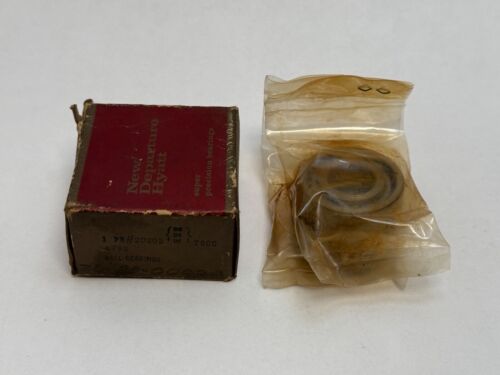

4) There are cloned fakes (just like the Mitutoyo calipers), in NSK boxes that look legitimate but are not to specification, choose your source carefully.
5) I found a bearing shop in NewYork (eBay) that specializes in quality NOS bearings for affordable prices $50 pair, every pair they sent me was as per description and high quality.

Do you have a link to your eBay seller?
I'm going to talk to a local supplier about what they stock for matched 7202's. Also getting a pair of 6202's from them on Friday.
Given that I got such a deal on the whole kit I think spending a few dollars on replacement bearings makes sense.
Might be worth giving him a call 585-617-3500

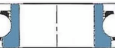

Don't spend money on a matched set until you have a plan for mounting them, your current setup won't make any use of a matched set.
I see a few ways forward.
1. Do your best to determine the space between the 2 bearings and make a spacer bush to fit, minus a tiny amount for preload. Give it a try with cheap, non-matched 7202's
2. Modify the current mount setup to use a pair of matched 7202's back to back, with a separate shaft seals (i.e. no seals on the bearings like your originals).
3. Use an off the shelf FK15 from a reputable supplier - comes with 2 angular contact bearings installed, just open up a large hole for it to drop into and bolt it down. May require spacing your servo motor out a bit) - note that some "FK15" are sold with regular bearings, avoid those. Get from a good source.
FK15 bearing mount
I'd be leaning to #3 these days, easiest to do, and results are expected to be good. Not the cheapest, but solves a bunch of issues
Side note, I actually, just noticed that the BK and FK are face to face mounting for the bearings from Hiwin.
They could, but as suppliers of equipment designed for this application I'd trust them to have installed them that way on purpose.
No point messing with a quality part, and perhaps they are getting bearings that are matched for face to face preload only.
The SKF document I linked mentioned that back to back is stiffer for resisting bending. If side loads aren't what you care about, but absolute precision location is, then face to face will result in higher preload when thermal expansion occurs, versus back to back will loosen up with thermal expansion. I would not expect that either condition is a concern in your CNC (minimal thermal expansion and no side load like a spindle), so back to my original statement that I don't think it matters in this case.
