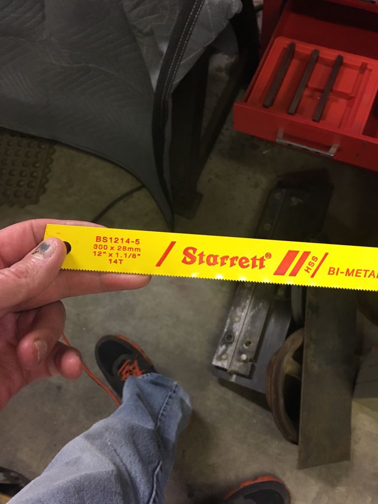

For blades I just ordered from kbc as they have a power hacksaw specific blade (starret). Blade was about 20 bucks
The blade will need a tweak to fit (Grind a profile)
The blades it came with are from COOP but I haven't seen anything that sturdy anywhere until I found the kbc blade

Looks like regular hacksaw blades, the ones I have a pretty beefy
I love it! Shuts off right on Q, makes a nice neat straight cut. I should probably source some of those beefier blades.

Hey Kevin, could you please provide a link to the KBC blade you mentioned. Looks like I need one.
