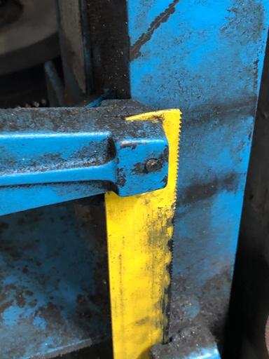

Hey Kevin, help me out here. What does the blade tensioner on your PHS look like and how does it work? Looks like the one on mine has been jury rigged and I'm sure is the culprit causing the vertical cut to wonder.
Note that the tensioner sits in a slot on the arm. Does yours like a slot like this?
Another thing, the back blade attachment slot will not accept a blade .05" thick on my PHS. Does yours or did you thin the blade to mount it?

The blade will need a tweak to fit (Grind a profile)
The blades it came with are from COOP but I haven't seen anything that sturdy anywhere until I found the kbc blade
Kevin,
Did you have to thin that blade as well as reduce the depth to make it fit? The one I just got doesn't fit into the slot on the back mounting support.
I'll check in a bit craig.... can't recall off hand. I know the blade it came with had been 'tweaked' with some grinding.

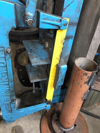

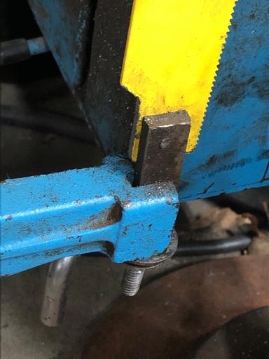

Tough to say, as I don’t recall the act of modifying the blade, but here are some pics
It’s for sale btw in case u want a parts machine
My Starret blade fit fine but needed a spacer on the front I’ll have to look at that one day it’s probably a buggered thread issue.
this is the lifting mechanism it rides on a lobe.
