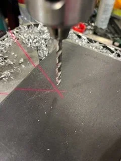

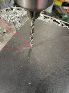

I'm going to add a second tool (or add on), laser crosshairs on a drill press.
While most of use that drill a fair bit develop a sense of where to place to spot to be drilled and can do so fairly consistantly. But adding target crosshairs referenced from the drill itself helps you locate and drill faster.
I bought mine from BB for about $50.00, worth the money spent.

Please tell us more. Model #, link, photos, how it maintains target with table movement, etc.
Do a good initial set up and its done, as its attached to the column just below the head the lasers lines cross in axis with the spindle travel. Table movement has no effect as the head is fixed to the column and the lasers are fixed to the column. AA powers it and as long as you turn them off they last.

Does it actually stay on center when you move the table up/down or even when using different thickness' of material?
With the lasers fixed to the column I'm trying to figure how it tracks center. I would expect that as the table goes down the center point would move out toward the operator and the opposite when the table is raised.

I think, that if you picture each laser as projecting a flat plane of light that is vertical, the line where the two planes cross will be vertical and "infinitely" long.
Perfect explanation! The part I was missing is the plane of light instead of a line!
My compliments on a very simple very clear answer.

No it tracks because it uses 2 lasers that cross, think two sheets of paper crossing vertically as long as the are plumb and aligned, no variation.
Remember this is not a precision device just a tool to make the initial start significantly easier.
Look at the photos I posted earlier, unfortunately to keep the size small, detail is lost but if you carefully you can see the shadow of the bit as it come close to the surface.
