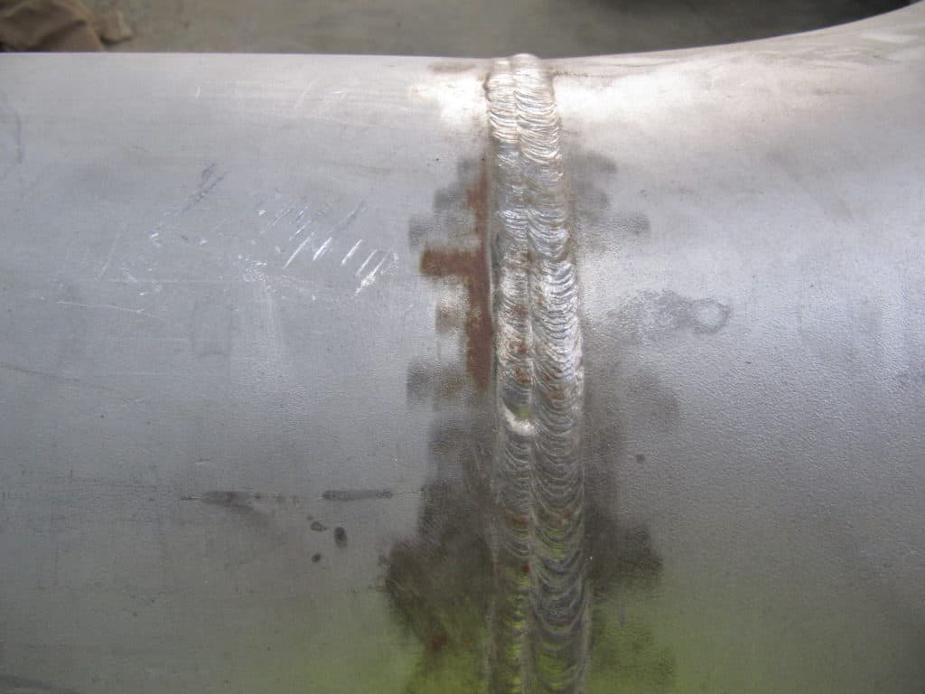

It's not contamination from the hard cutting tool edges, it's from carbon steel particles that may be adhering to the cutting tools.
In our stainless fabrication shop, we use a spectacularly nasty cleaning paste called Antox 71 to clean stainless after welding. A combination of nitric and hydrofluoric acid, it dissolves the outer stainless steel oxide layer and any free iron or carbon contamination. Has a truly unique anti-human property - if you get it on your skin, it produces an acid burn. But if you don't rinse it off immediately, the hydrofluoric acid absorbs into your skin and dissolves the bones underneath.
