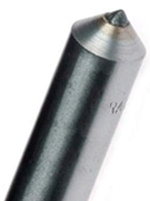

A tool I didn’t know i needed. It is great. On sale for $10. I tried it and it is absolutely awesome.
I confess I've always turned my nose up at both kinds.
This is what I have used for 50 years. I still have it and it still works just as well today as it did when I got it. It can also be mounted in a fixture to dress bigger wheels or surface grinder wheels.
It is sorta like @Ironman 's diamond drills but purpose made.
Diamond Dresser Single Point Grinding Wheel Tapered Point Tool 2.00 Carat - 1/2 Inch x 6 Inch https://a.co/d/2kSP3Co

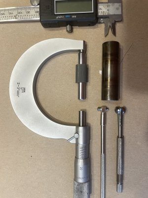

Questions:
The sphere ended telescopic gauges, I guess these are more accurate than the standard ones? IIRC my cheap telescopic gauges have rounded tips, but spherical seems better.
In what situation will you use the triangular plates?
Not sure if i understand your question - but here goes- I’m new to both of these measuring tools. They are designed to measure the ID of a hole. The small sphere ended set is for holes 1/8” to 1/2” and the sideways telescope set is for 5/16” to 6” diameter holes. So I played with them and measured the ID of a piston wrist pin using the largest sphere type and the smallest telescopic type. I compared that to callipers and got surprisingly similar numbers.
(0.463 to 0.469”). This range is mostly from the ID hole variation not the type of tool being used. (Note: I was able to determine that the wrist pin ID is a bit egg shaped and also a bit larger in the middle than at both ends). The callipers can’t show hole diameter variations deep inside the hole (but both of the expanding tools did and gave similar values). I like the way the sphere type can slowly be expanded (whereas the telescope type springs outward abruptly.
These are knock-off and inexpensive China noname (from Amazon).
Certainly not precision instruments like Mitutoyo would offer. But just fine for me.
Previously i have used a small plastic triangle to set a part on a 45degree angle in the milling vise. These will be: easier to use; more accurate; have 30 and 60 degrees as well as just 45; and i can use a small magnet (as a third hand) to hold the triangle while holding the part at the same time as tighten the vise.
