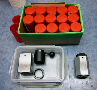

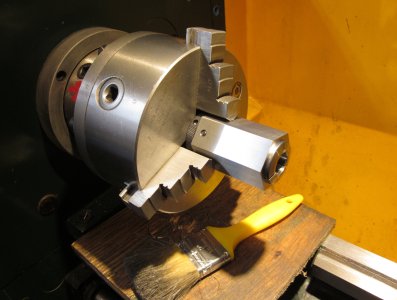

After using my shop made R8 collet holder I ordered a set of 5C collets and a pair of collet blocks.
They are from Accusize on Amazon. The quality looks good for the price.
I will need to make a wrench for the nuts.
The nut is .040" too big to fit into the chuck so my next project after the wrench is to make a smaller nut.
In that same vein my John Stevenson er32 collet blocks (square and hex) I bought from arceurotrade years ago before the flood of imports have paid for themselves time and time again. They were reasonably price and well made, but I remember the shipping making me choke at the time :D. IMO you can never have too many options when it comes to holding work, or holding tooling.
