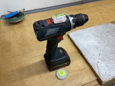

I wish I’d done this modification years ago:
They’re ”keyed” into the moulding of the drill and I attach them as needed with tape.
Don’t use garbage duct tape, the heat from the drill makes it a bugger to remove…

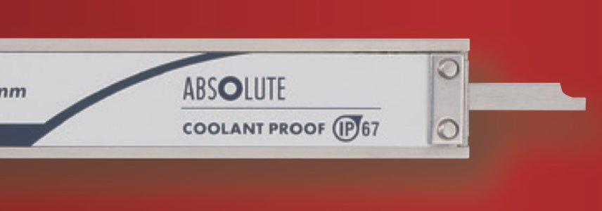

It hurt to buy these Mitutoyo Coolant Proof Calipers, but boy are they nice:
The Coolant Proof model can be a real ‘plus’ if you are using steady coolant flow.
