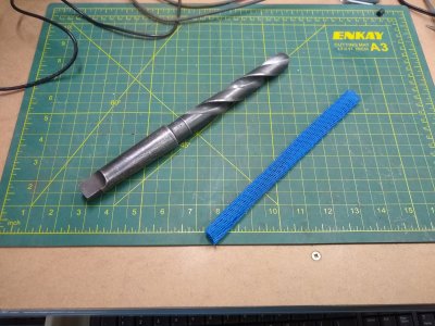

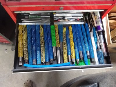

When I was at my buddy's truck shop, I had to replace a number of air brake air chambers ("brake pots") on trucks, tractors, and trailers. They all come with extra long actuator rods that are cut to length for your particular application. The threads are protected with a sleeve that remind me of what I will refer to as "East Asian Finger Trap" type weave. Well, they're free, and are great for wrapping big drill bits, big reamers, big taps, etc. so they don't get banged up in the tool box. If you aren't connected with any truckers I bet bringing a dozen doughnuts to your local heavy duty shop would get the techs there saving them for you.
I know a lot of people have racks for their MT drill bits but a drawer is more space-effective for me. As a bonus, you can pretty much read the labeling on the bit shanks through the weave.

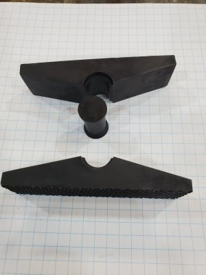

I had to make a threaded sleeve to protect the threads on a threaded shaft. In my case to protect the threads of a rifle barrel to which a muzzle brake is attached. The thread protector I made is knurled on the outside, and with an internal thread, in this case 9/16"-24tpi.
Whenever I make a part that has internal thread, over 1/2", I like to cut 95% of the thread on the lathe, then finish it off with a tap. In my case, I do not have a 9/16-24 tap, so I had to do all the thread on the lathe. Its easy enough to check the progress of the threading operation if you have a short male section: see if it screws all the way in, if not, remove another thou and test again. But I had to test the internal thread by trying to screw on the 24" rifle barrel, which to say the least is awkward, and you can easily damage the male threads on the barrel. So I get to the point that it seems to be fine, without screwing the barrel all the way on. I had already knurled the part, and thinking the internal thread of the protector sleeve was proper, I cut off the part. Deburred the inside with a wire brush attached to my cordless drill, and proceeded to thread the new sleeve onto the barrel threads. Of course, it only threads on about half way nicely and then gets tight. You can't force it: stainless on stainless, it will gall and weld itself together. So now what? I have to open the threads just a tad to make it thread easily all the way on. I can't work on the male threads, because the muzzle brake threads on perfectly. I've used many techniques in the past successfully. So 1st try: a wooden dowel coated with grinding paste. Screw the part onto the wooden dowel, in and out. The dowel should be as large as the major diameter of the thread or slightly larger. This usually works well if it just needs a smidgen. Not this time. 2nd try: find a smaller tap with the same pitch, in my case 7/16"-24, place the tap in the threaded sleeve, and roll the part, just like rolling dough. Of course being carefully that the tap threads are nestled in part threads, and test often. This worked perfect.

As usual, that is cool work! I like this one a lot because I have this problem from time to time too.
Usually I just test fit with the matching part and creep up on the part with the threading tool until it works. This has always worked for me provided the parts are still mounted in the lathe with the threads still properly indexed. Picking up the thread with a refixtured part that is only a few thou from completion does not work well at all.
Sometimes I have used lapping compound by starting carefully with compound at the far end of the female thread and working outward toward the front so as to avoid excessive lapping on the initial thread when the part cannot yet be fully engaged. But I don't like that approach at all. Yes it works, but I have never learned to trust the final result.
Usually, I end up making a special set of go-no-go plug gauges. Basically two duplicates of the male thread measured with a thread micrometer, a regular micrometer, and a knife micrometer so I get the thread root right, the thread OD right, and the thread pitch diameter right. These gauges are then used to make the matching parts a perfect fit. This is a lot of work. Thankfully, it is often work I can use on future work so I don't usually mind doing it. But still, if i could avoid it, it would be a giant step forward.
So I am keen to understand what you are doing better than I can discern from your description.
How are you keeping the tap cutting edge held solid enough to cut evenly around the circumference?
Are you actually cutting or are you really just taking off a few rough spots or high spots?
Would an inside wire brush work just as well? Perhaps with some valve grinding compound on the brush?
I'm aware of the fact that this is just a cover cap to protect the threads. If so, the thread fit between the two parts isn't really that important. Why didn't you just cut the cap thread a wee smidge bigger than needed and depend on the 60 degree thread profile to center the parts when the cap is hand tightened during final installation?
I'm also wondering if you could do a taper at the interface to guarantee a perfect fit that only relies on the thread for fastening such that thread alignment isn't that important. It wouldn't be universal anymore and your gunsmithing application might need to be universal to fit other aftermarket parts, but for one-offs it might make the whole thing a lot easier to do.
That is what I do as well, as I did this time, but the cap was in the chuck, and I tried fitting the barrel which is awkward, trying to keep it straight, threading on, and deepening the thread. I was eventually able to screw the barrel onto the cap easily halfway, and assumed that the thread was finished. You know what the say about "assume".
