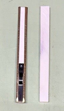

What I was trying to do was caution those not familiar with soapstone from picking up something like the Silver-Streak™ marker strips:
Silver-Streak™ on the left, soapstone on the right (difficult to see the difference, but the SS is silver & soapstone used for marking is white to light grey).
Welding and sheet metal crayons would not be a good choice for keeping files pin-free as they contain waxes which would interfere with the cutting action. Similarly, an offset from a soapstone countertop would not be a good choice if not carefully selected as finished countertops are oiler or waxed to protect the surface and to enhance its appearance.
I have never felt chalk was any good, but I am sort of the opinion now that anything that fills the deep recesses of the file to prevent chips wedging in would work after a fashion.
I prefer soapstone and think the silver markers would be not good, but expensive too.
