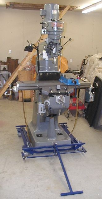

The X axis play comes out at .035 and the Y is .020 and even through the travel so more reason to be pleased.
If the wear is even across the length of the screw, chances are that you can tighten the nut a wee bit to remove a lot of that too. That's what happened on my Hartford. Just be careful not to over do it. A little backlash isn't a big deal as long as you know it's there and know how to work with it.
If you overdo it, you can accidentally accelerate the wear.

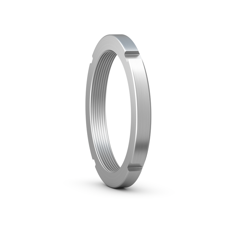

That's one thing that's still on my to do list, I have to make up a special tool though. If you didn't know, the Long Chang/First (& Sharp etc.) back lash adjuster/lock nut is not like a BP, you need the special tool to turn the adjuster sleeve and the ring lock nuts - see the lock nut image below.
Tool designed but not yet built.
Interesting to note that the leadscrews seem to be wearing very evenly (if at all?), probably because the nuts are part of the one-shot oiling circuit so they are regularly lubricated vs. what I have read about (some?) BPs that rely on splash/drip coming off of other parts (if I read correctly).

I'd guess your screws are not worn at all and it's all in the nuts.
If I had that problem making a special wrench for that, it might not happen. At least yours are on your to do list.

Dipsticks? Maybe for not making a piece by piece copy of a BP but on the other hand from what I've seen in BP documents the LC way might be better except for the tool. In the small details it generally looks like they kept the interface/form factor of the BP but made small common sense mods for their production. There are quirks in there, the M6 R8 key is one. I was expecting to find the same oddball BP set screw pair but the First/LC parts are common off the shelf parts except they're metric. The socket head cap screws holding the rear chip protector mat on the column are 1/4-20 but the head hex is metric - seriously! I've learned to not assume what I'm going to find for fasteners when I put a wrench on this thing! I'd still rather deal with the mix of metric and imperial in this machine than the unobtainum BSF/Whitworth fasteners in my Brit. Myford lathe!
Anyhow, you can probably buy a tool from Sharp, (they supply one with each new mill) don't know the price nor have I seen anything but a line drawing so I can't really say how good the tool is but it doesn't look convincing to me so with all that I'll go ahead and make my own version.

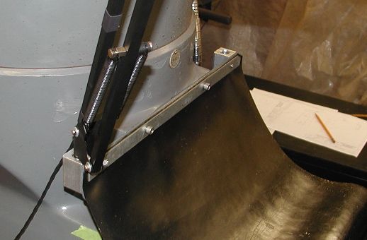

I get what you mean about minimizing interface tools, the flip side is that the 1/4-20/metric hex breaks the rules about non-standard fasteners when it's just not needed. I can argue the 1/4-20 makes sense because it's the same as a BP and that's what a maintainer would expect to find on a cloned BP. Less chance of messing up the threads by trying a metric in the hole by mistake.
I'm not complaining, I replaced them with longer STD 1/4-20 SHCS to enable me to add a lamp bracket held by the same fasteners. I would have left them if I wasn't adding the bracket. I did change out the smaller M2.5s that hold the rubber sheet in the support strips with #4-40 though since I had those on hand in a longer length and not the metrics plus it makes everything on that end all imperial.
