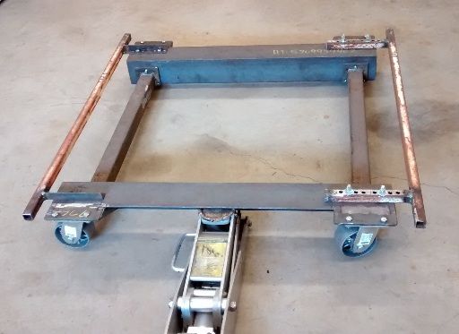

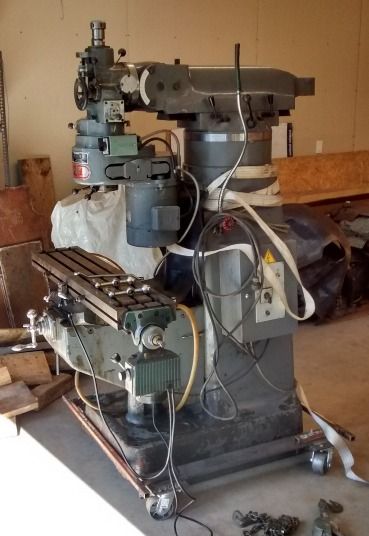

I talked about making a dolly to move the mill around on and to use as a base in my shop, here’s the dolly.
It’s 4 x 4 x ¼ angle with 2 x 2 x 1/8 tubing joining them and 720 lb. rated steel wheel casters. All the numbers worked out for the weight of the machine. The 1” tubes across each end are to keep the machine in place on the dolly and will be adjusted to fit. Once the mill was in the trailer the dolly was raised and set on blocks to get it off the wheels for the trip home. I’m pleased to say that the dolly worked great as planned for the load and offload.
The plan is to move the mill into place and either take the wheels off and set the 2” tube on the floor or leave the wheels on and rest the dolly on 2 x 4s to take the weight off the wheels. That’s what the floor jack is for.

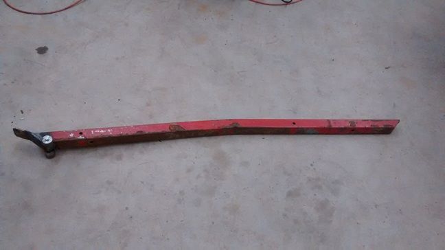

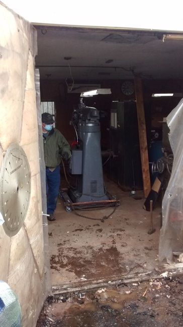

I arrived there with knocked down dolly in hand and a Macgyvered wheeled lever cobbled together from odds and ends including a rub rail from my last race car. If you’re ever going to move a piece of equipment you want one of these! I should have made the tab out of something a little thicker because I bent it sometime during the move.

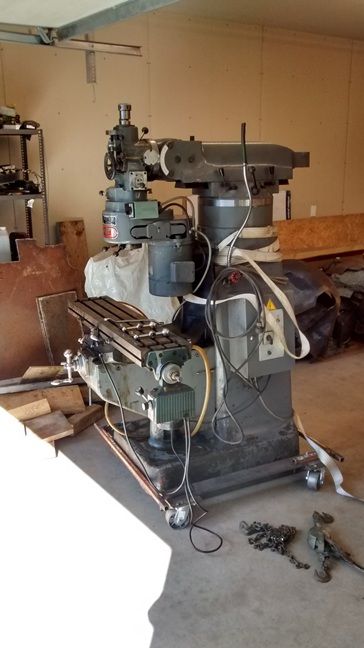

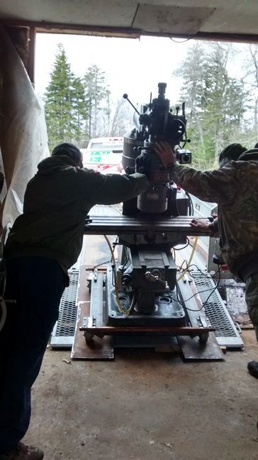

My S.O. and I went, planning on having help from the late owner’s son, but we wound up with the whole family and it worked out great. I started by briefing everyone on what was going to happen and thankfully they all got with the program and let me orchestrate the show. Lucked in there! I can’t say enough how important it is to do a pre-operation brief so everyone knows what’s going to happen and that you know what you're doing. That and safety management.
The mill needed to be rollered out from against the back wall to where I could lift front & rear to block it up high enough to slide the cross members under, bolt the angles to them and then raise enough to get the casters on.

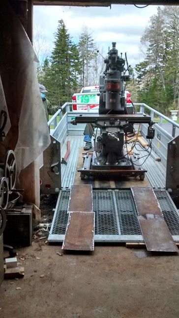

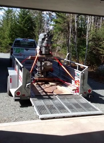

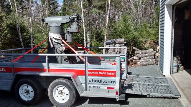

From there it was line up the trailer, line the ramps with steel plate and come-along the mill up onto the trailer, column first for stability. I had dropped the knee, rotated the head to motor down position and moved the table to the column to manage the c of g. Loading actually went very well with lots of hands to guide. Not much load on the come-along either. I think if I did it again (and had time) I’d arrange to lock the swivels or only have 2 swivelling castors – hindsight.
Once on board the trailer the mill was moved to slightly bias weight to the trailer tongue, put up on blocks and lashed down with the come-along, 4 @1300 SWL straps to the column and 4 @500 SWL kept the base in place.
The trip home was uneventful and the offload was OK although more hands would have helped but we managed by moving slowly and methodically. The one thing I regret when building the shop is to not have set a big eye in the floor at the back wall so I could winch things off of trailers. This is the second time I had to make do unloading something and in this case I couldn’t get enough slope on the trailer for it to self-unload.
Anyhow the machine made it home safe and sound!
Now a few words about the trailer. @Dabbler mentioned that in his experience U-Haul and other trailers did not have adequate tie-downs so the week before the move I went by the local U-Haul and checked out their 6 x 12 dual axle trailers and found that they had suitable tie-downs and an adequate ramp so I was confident that I was prepared. Well, to my surprise the 6 x 12 trailer they picked out for me and had hooked up when I arrived had tie-downs in it that looked about the gage of paperclips! Fortunately they had another and quickly swapped it out without a peep. Heed the warning from @Dabbler that the trailer you get might not be adequate.
A snatch block and a length of aircraft cable come in handy, letting you load and unload a trailer easily. Position the snatch block in the middle of the trailer, run the aircraft cable down the trailer to the piece being loaded, hook the cable to a vehicle/tractor and yank it on. Opposite for unloading. (And if it’s a janky pull you can move the snatch block to different sides of the trailer to change the angle of the pull)
To actually get it into the garage you’d still need an anchor point inside the garage, for the snatch block, but it wouldn’t need to be heavy for just a mill.

Hi @Chicken lights. In my case getting on the trailer was straight forward because the trailer had convenient & beefy tie down loops I could center a come-along on with a loop of chain. Getting on the trailer was more of a cardio work-out with the come-along than anything! It was the getting off the trailer part that was more complicated.
In my case I have a car in the shop (multi-purpose shop!) so I hooked a chain to a tow hook and all I needed to move the mill was to pull up on the chain span (which multiplied the force by geometry) but unfortunately the car was off center so I had to jig around a bit to pull & straighten. I kept the come-along connected with some slack cable to manage movement/prevent overrun but the trailer & ramp were about level going into the shop so not much help toward self-unloading!
In the end it was done safely, that's the important part. I'm going to have to put my thinking cap on for a loop at the back wall though for future need.

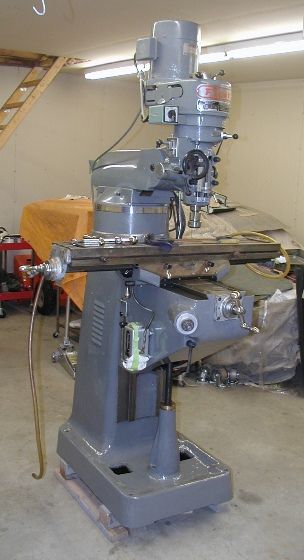

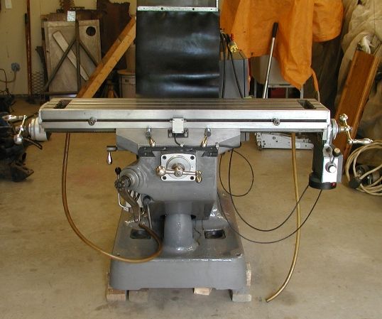

It’s about time I got caught up on the story of my First mill, I’ve had my head down doing the clean-up and maintenance to get it to the point where I want to call it ready to put to use. Basically I wanted to set a baseline where the to-do list was minimal.
This is where I started: Lots of general grime and a fair bit of flaking bondo around the column/base.
I spent a lot of time with a stiff bristle brush, scraping tools and a can of Varsol removing 35 years of accumulated grime, lubricant and cutting oil residue and even traces of Cosmoline. Some of the cutting oil residue was more like varnish and took a fair effort to clean up.
After clean-up, I’m pleased with the general condition of the machine, other than cosmetics it seems to be well cared for, little wear and not abused. The one shot pump reservoir was half full and there was oil on the ways so it looks like the pump works and was used. I notice that there is an oil feed to the lead screw nuts so that’s good for longevity.
The X axis play comes out at .035 and the Y is .020 and even through the travel so more reason to be pleased.

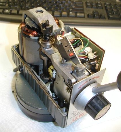

Digging into some of the components I decided to have a look at the power feed for the X axis. I needed to replace the circuit breaker/switch, the plastic lever had gotten bumped during handling and broke off so I had to dismantle the unit to get at it.
When I got it open I found the cable entry strain reliefs were in need of replacement and the neon(!) power indicator lamp was black inside so while it was open I replaced that too. Finally, the fast feed override push button mechanism needed cleaning (more brown varnish) and its flexible cap needed replacement. Other than that it got a thorough cleaning and re-greasing.
While I was at it I replaced all the cabling from the power distribution box and also the cable to the table limit switch because the jackets were cracking. I also overhauled the limit switch because it too was covered with and full of the brown varnish like cutting oil. In the end I also replaced the plunger spring (Grainger) inside because it was broken and I made an actual gasket for the cover to keep contaminants out.
Finally I gave the housing a thorough cleaning.
After that overhaul, the power feed will be good for another 35 years or longer than I expect to need it!

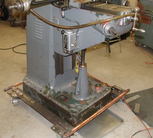

The next thing to look at was the cutting oil/coolant pump. From looking in the drain back holes in the base I knew the sump would need some clean-up since I saw chips and even a shell casing in there so I drained the oil and dug in. As expected there was some debris at the drain back ports so that got cleaned out. I’m planning to put some sort of fixed retainer on the drop-in gratings but that will come later.
Next up was checking the pump. At some point in its life the pump bracket parted company with the pedestal casting (2x 6mm bolts) so the pump was kind of laying there over above the sump. Easy fix and the pump works fine.
At that point I propped the mill up on blocks and took it off the dolly so I could get full access to the base for paint touch up and also paint the dolly. My approach was to make the machine respectable looking and seal all the open surfaces rather than a full like-new overhaul (or quick cosmetic cover-up) so I smoothed up the old bondo as much as I had patience for (awful stuff) primed and painted. The (2K/epoxy) primer is important because it seals the bondo etc. against being softened by the top coat. I also used 2K top coat because it cures quickly and is very resistant to chemicals. I managed to get a good match from my local NAPA using their scanner, turns out the closest match is Mercede$ grey LOL!
So, here’s the finished touch up, not bad if you don’t look closely at the base but more importantly for me it’s all one color and looks pretty good when I look at it, ‘way better than when I got it.
After washing and cleaning the cutting oil residue I used some rust remover to clean up any red dust residue caused by humidity and gave the table a brushing and I was pleased to see how good a shape the table was all around. On the work surface it is “flaked” and doesn’t show uneven wear from end to end and there’s only one small crescent about 1/16 wide at the edge of one of the slots where someone got too close with a drill bit so I’m really pleased. There are what are probably typical dings from dropping things on the table and I have to come back to those.

The last little bit for this instalment is the update on the dolly I have the mill on. As you can see from earlier in this thread the dolly I made for handling the machine on the trip home and in the shop worked out great for the move but would have been better without all 4 wheels castoring. I fixed that. The dolly now has two fixed and two castoring and the castoring wheels are linked and steerable. The dolly update story will come in the next instalment.
