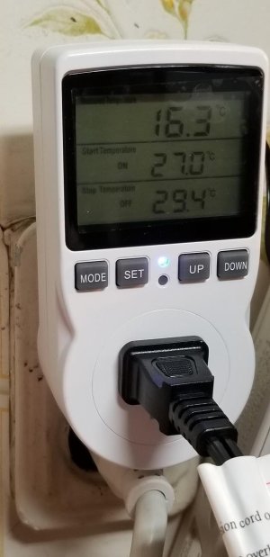

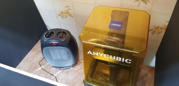

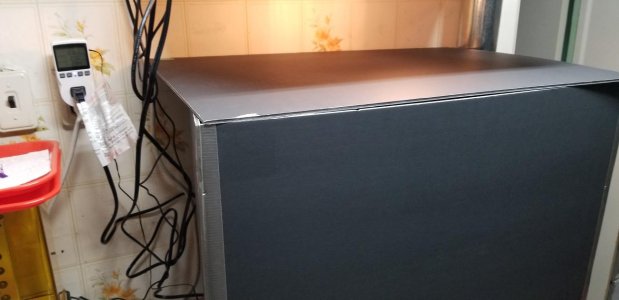

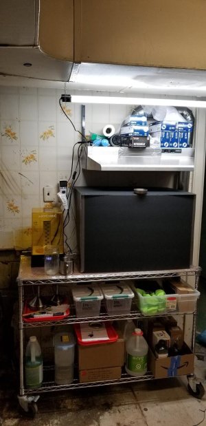

This was a little more than $100 in total a year ago, higher today., One way of getting control of the temp....it all packs away and was fairly inexpensive.
heater is amazon basics. was $34 a year ago, now is 42. https://www.amazon.ca/gp/product/B07V6M4MSN/ref=ppx_yo_dt_b_search_asin_title?ie=UTF8&psc=1
The thermostat is a Petuivcor Thermostat Outlet Plug which was $43, now not listed as available :(
There was also some creative accounting around not adding the whole foam board purchase price as I used about 1/2 of it).
Foam board was $60 a year ago.
Similar solution to what I had, but a bit more elegant!. And elevated. I like it. I bought a thermostat like that for the hair straightener. It "worked" but was a pretty janky setup..... It was a simple enough proof of concept that led me down other avenues towards the cartridge heater and custom vats. Looking that up made me realize it's been 3 years since I bought it.... Didn't seem like that long ago.... I liked the oil radiator because it didn't blow the air around, but it quit working and I tossed it :(. My plan for the new workbench area will be a station similar to yours, but with a fully enclosed fume hood style I can close off with an insulated panel to keep the heat in. I also want it to function as a spray booth for airbrushing too, and maybe an extractor for a burnout oven..... So many hobbies......lol
